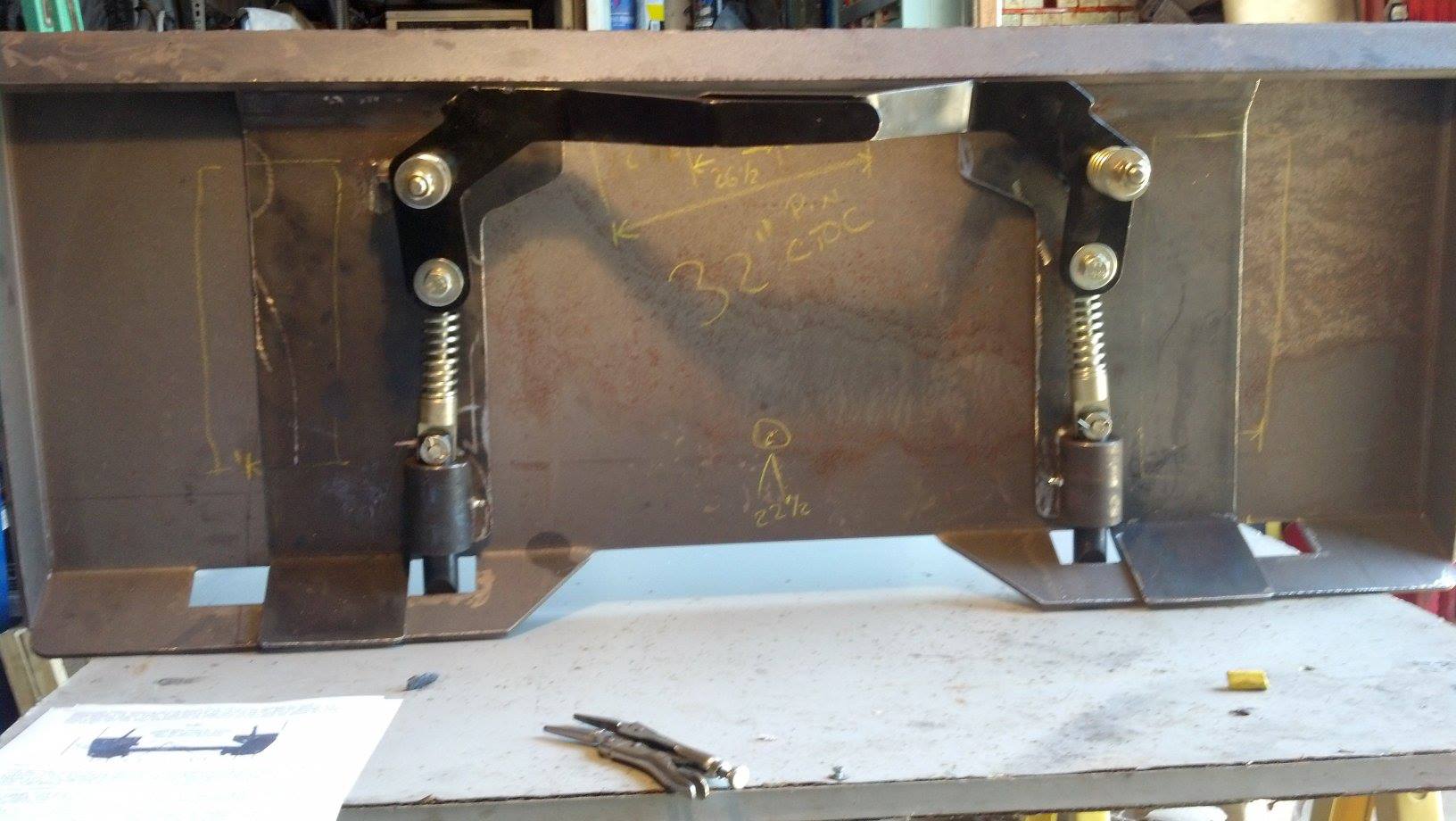

Started accumulating some parts for my SSQA project and since all the factory backing plates and attachments seem to have the narrow "case" holes @21"OC I'm thinking of using this spacing for mine. By using this spacing it will allow my bucket brackets to weld right onto the latch plates without a standoff and keep the pin to back of bucket distance almost stock. I think I will also section the back plate so its only as wide as I need it and not to the full 45" ssqa std.
I drew in apx where the brackets will go by using the case specs.
