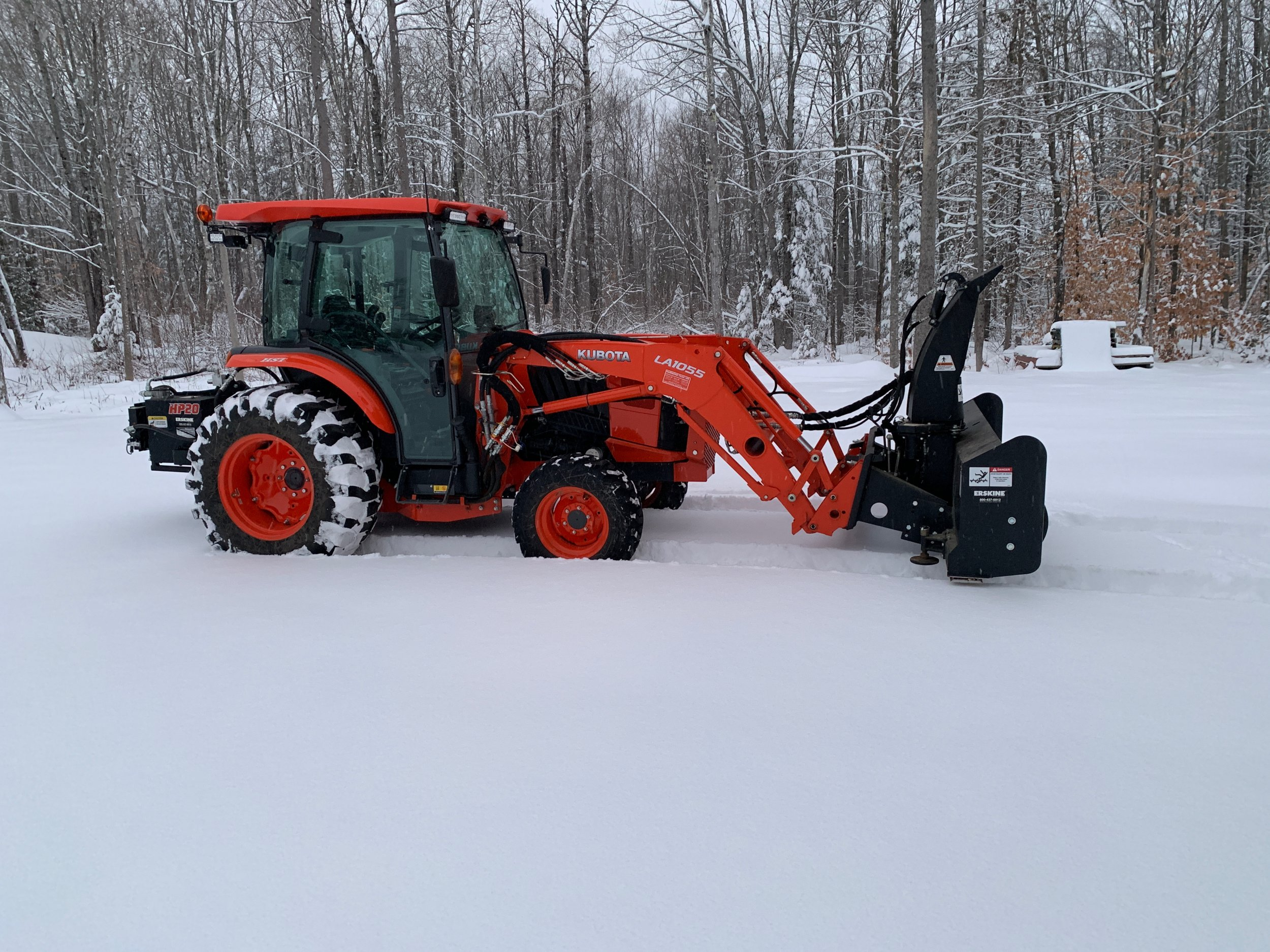

I have a Kubota L5740 and for years have been clearing a 1/2 mile road plus parking areas with a rear mount PTO snow blower. It works well, but as I get older, being twisted around to see and work backwards is getting old. So I have started thinking about a front mount snow blower.
Kubota of course makes one, but it involves a substantial sub frame that doesn't look easy to install and remove, and as I understand it, the sub frame is incompatible with using the loader. So even if you remove the blower itself, you still can't use the loader unless you remove the whole sub frame. That just won't work for me.
So I've been thinking about using a skid steer snow blower. I have a SS mount on my loader, and I have front hydraulic remotes that could be used for chute rotation. But I don't have enough hydraulic power to drive the blower. I've seen specs in the 16-21 gpm, so I'm figuring on 20 gpm as a round number. I think my choices are a rear PTO pump, or a mid PTO pump. The mid PTO runs at about twice the RPM of the rear PTO, so a smaller pump will work, But somehow I'd have to mount and secure the pump. For a rear PTO there are a variety of commercially available kits, but on first check they seem a bit pricey.
Anyway, I'm interested in thoughts on this approach, and especially interested if anyone has done this before.
Thanks in advance

I stumbled on a blower company that does have a gas motor mounted on the blower assembly. Ibis too bad AG tractors do not put out high rpm's on their hydraulics.
Why isn't a rear PTO pump good enough?

But to be honest, the only negatives I've heard regarding a front mount, hydraulically drive snow blower as originally contemplated are 1) it's easy to end up under-powered, so size everything carefully, 2) it's probably more expensive than a pull-behind (but less than a frame mount front blower). 3) the PTO pump is heavy and hence difficult to install/remove.
I have already decided I'm willing to pay for something that is front mounted, or that allows me to work facing forward most of the time. So that issue is off the table. And I know I can live with a bit less power - say 10-20% - but probably not less that that. I think that's achievable, and we have at least on L6060 owner who finds it works well in similar conditions. So I think it can be done if I so choose. That leaves the PTO pump weight, and presents an interesting challenge to either come up with an assisted way to hang the pump, or a way to drive it with a shaft.

Hayden,
I must admit that I just scanned this thread and may have missed another response about the Kubota subframe and loader compatibility.
We have a 5240 with a cab and the subframe and the front PTO blower.
The blower works great.
The subframe stays on and works WITH the loader.
The subframe is heavy (1,500 pounds?) and low, increasing stability.
I made up a short steel link to replace the hydraulic cylinder when the blower is off to avoid the blower-mounting "tongue" from drifting down.
We live in the mountain west and our snowfall is way down and the temperatures are way up.
Snowblowers do not handle wet snow well and are overkill for small snowfalls.
Last winter I did not even mount the blower and got a Landpride blade for clearing our long driveway and related areas.
If next winter is similar, I may sell the blower and subframe and just stick with the blade.
Of course, doing that will probably result in the return of 6-foot fluffy drifts :).
Anyway, on the 5240, the subframe and loader ARE compatible.
Your 5740 may be similar.

We bought our front blower, pto power pack as a package. If you size your own make sure your hoses are big enough. Ours uses 1/2 inch hoses with flat face connectors to get proper flow.

i have a front mount hydraulic blower on my unit. purchased in 2010. works flawlessly since then. i have a rear 25 gal hydraulic powerplant. i had bids for a quality built rear 3 point blower in the 6-7 grand range, but got this unit for about 2x that price.
doesnt matter, as a rear mount would not work for the projects i needed this for. i had to be able to lift it high to clear roof shedding. and a subframe mount would not lift far enough.
