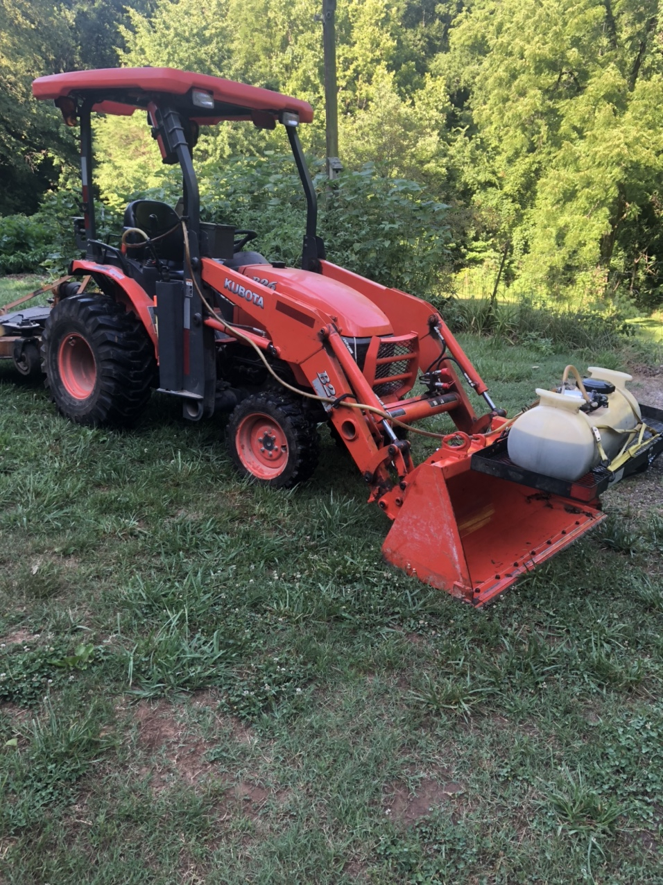

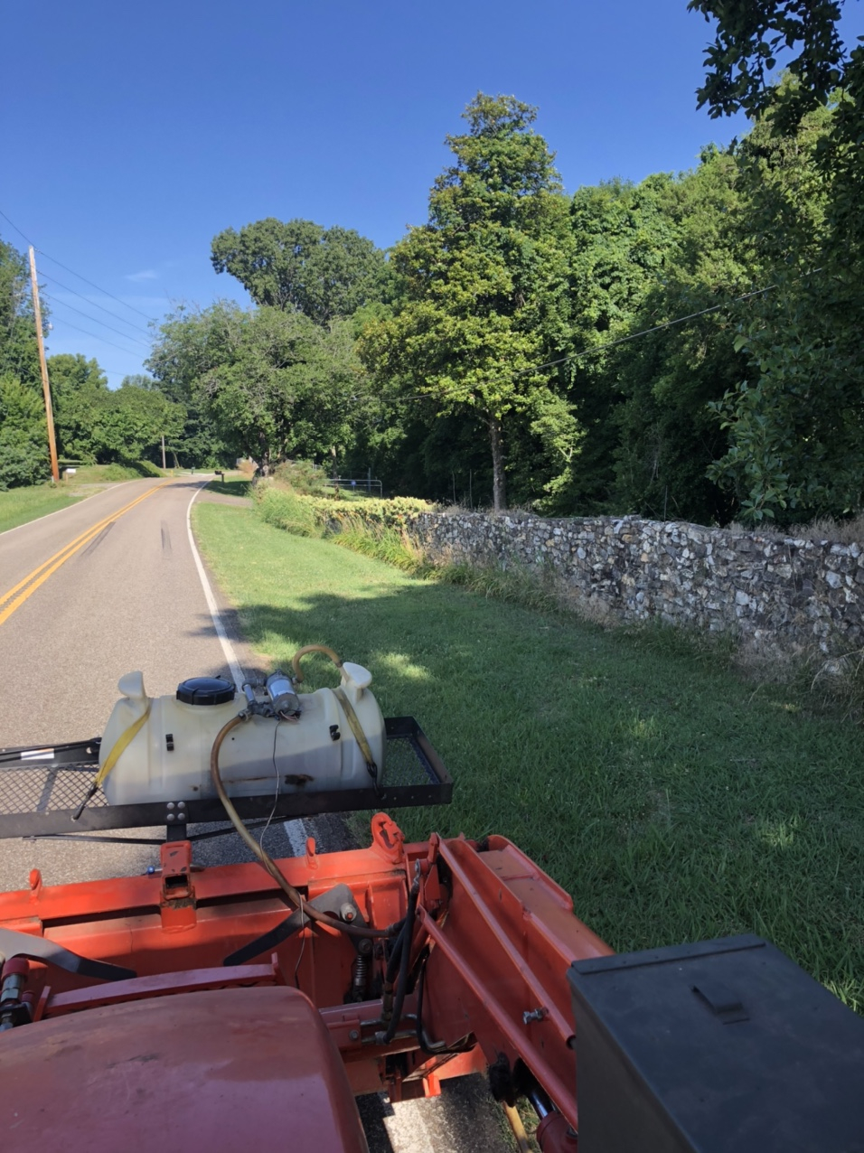

I have a receiver hitch on top of the bucket to hold a trailer hitch platform to hold the sprayer tank. Electric pump, 15 gallon, 60psi, 2.2gal from Northern tool. Reach about 30’ from wand. Lot easier to wand from a open station tractor than a skid steer.
Have a 25 gallon also that the wand can clip on the tank, fan tip, and area spray behind a four wheeler. Might be able to run switched power and use the bucket and skid steer controls to move the wand?

For very limited spot spraying of the isolated kudzu plant that crops up in the field, I have considered using an electric spot sprayer because I could spray the plants when I spot them while bush hogging. I hadn't thought of mounting an electric sprayer to the receiver hitch on my FEL until I saw Smokeydog's post. That's helpful to me. Thank you.
