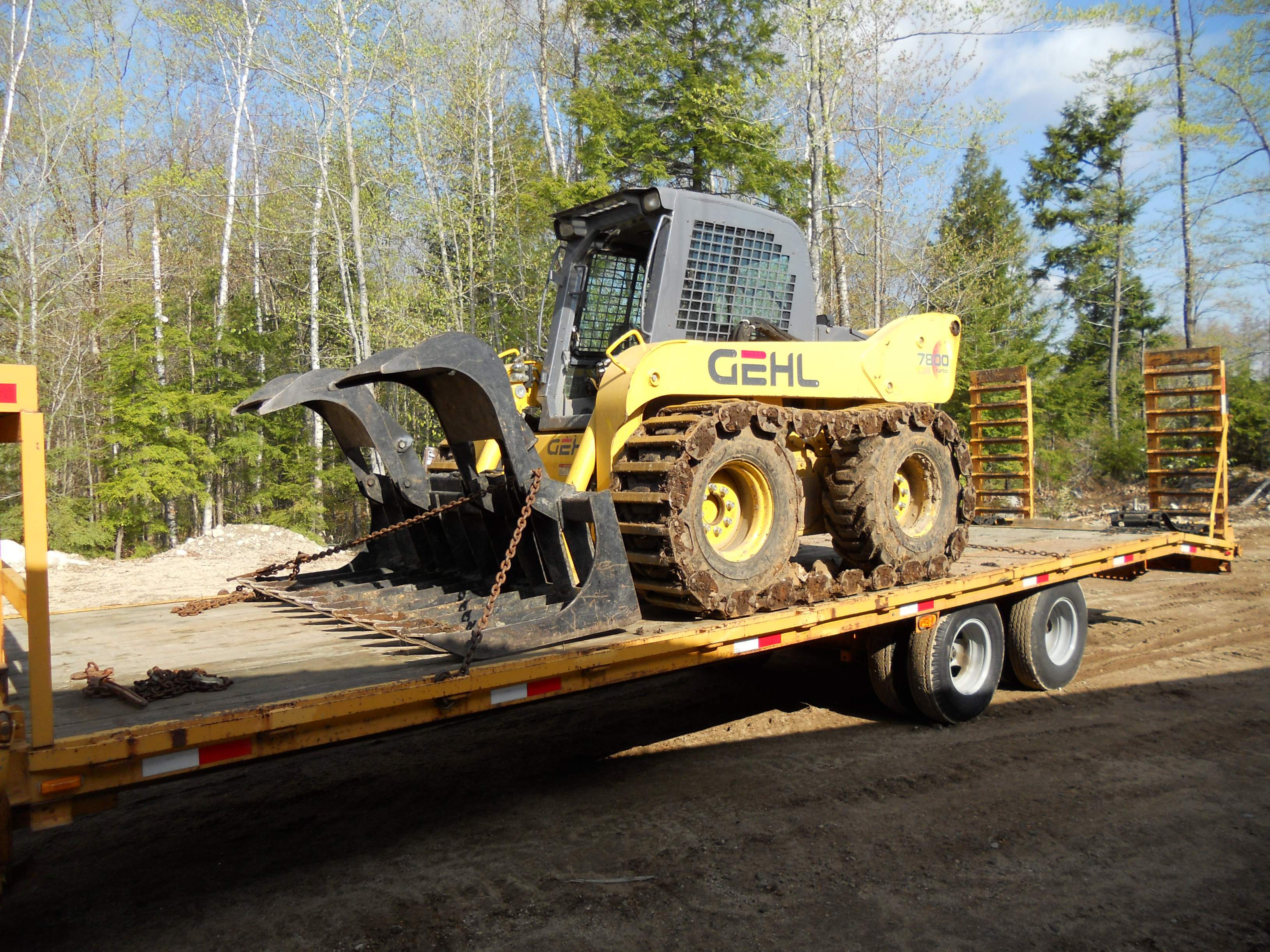

This will put brush just about anyplace you want + 12' high. Very stable @ 90" wide, it's "footprint" is almost square.

Rusty, that looks just like my set up except for the color. And I've changed my mind, I am glad I got the wheeled with the ott tracks. I've got other equipment for the finish grading.
That looks like a pretty Mean Machine and I'm sure I would be very happy with something like that.
