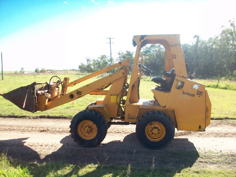

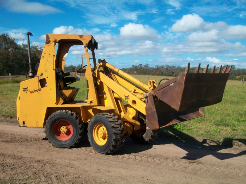

IMO given the limited specific tasks you have in mind I'd go for an articulated loader.
Something similar to this machine we use would be ideal; compared to any skid steer - it'll pick up c.1500lbs + to a greater height, has far better ground clearance, is simpler/cheaper to work on/maintain, turns on a dime & due to it's articulation doesn't chop the ground up, hyrdo drive with diff locks Frt/Rear means its almost unstoppable - grab a levelling bar on the 4/1 & you can also simultaneously pull the drag around the arena to get it into shape qucikly.
Cost us c.5K (in Australia) so they should be cheaper/easier to find in the 'States & equvalent units are are available s/h under Hitachi, Komatsu, Yanmar, TCM..brands..etc.
