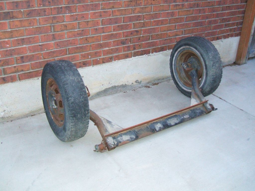

How big of an oak log are you talkin'?
The internet says (so it must be true) that Oak has a density of around 45 lb/ cu. ft.
A 2' diameter log is going to weigh about 141 lbs/ linear ft.
A 20' log of this diameter will weigh about 2800 lbs. ( -so make sure you use 3/4" plywood vs 3/8" when you make your bogie wheels. :D)
Your calculations may be a bit off.
Per the woodweb calculator the estimated weight would be 4,119 lbs.
/edit thats fo green wood
