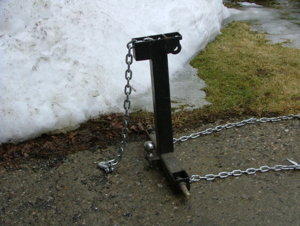

   / Skidding Cedar trees with my FEL? #10
Sparkkky,
Attached is a pic of the bracket I welded together about 4 years ago to drag and lift stuff with the 3ph. It cost me < $100.00 and about an hour of my time. I use it mainly to lift the log and then I attach a chain to the draw bar which would do most of the pulling to keep the center of gravity as low as possible. With it and my little B6000 with bald tires I would drag 25' logs with little effort.
Next is to beef it up a bit for the L3710, if it ever gets here! But I have no doubt it could handle everything the 3710 could dish out.
Gary
