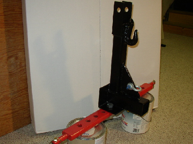

Even though some in this thread have done so successfully, I am dead against pulling/lifting anything heavy directly from the top link. Built a log lifter today from my EZ Mover 3 pt receiver hitch - just added the hook & a reinforcing gusset. Moves the lift point 6 inches below the toplink. Not appropriate for the biggest lifts, but good for most of what's on my 14 acres. Anybody tried this? Thanks for all the ideas & tips in here - Buckee

That should work for you. Thanks for the pic. You will be pulling from that hook as well as lifting, so I'm not sure you won't pull the grab hook apart. But if so, you can just weld a bigger hook in its place.
Now, what is the distance you ended up with between the lower arm hookups and the hook you welded on (or between the receiver and the hook)?

Better to have that grab hook loose to 'swivel' like you have, for adjusting to the direction of pull (and lift).
