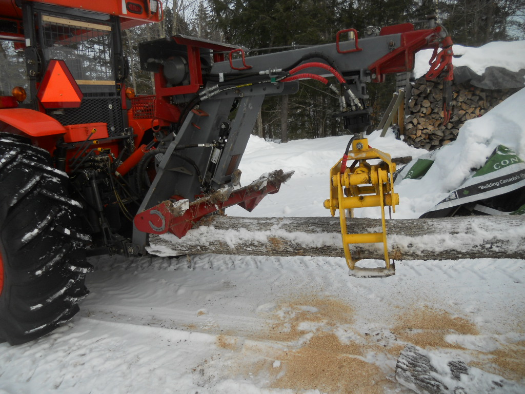

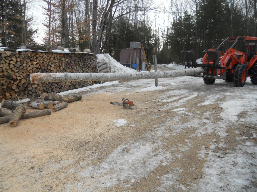

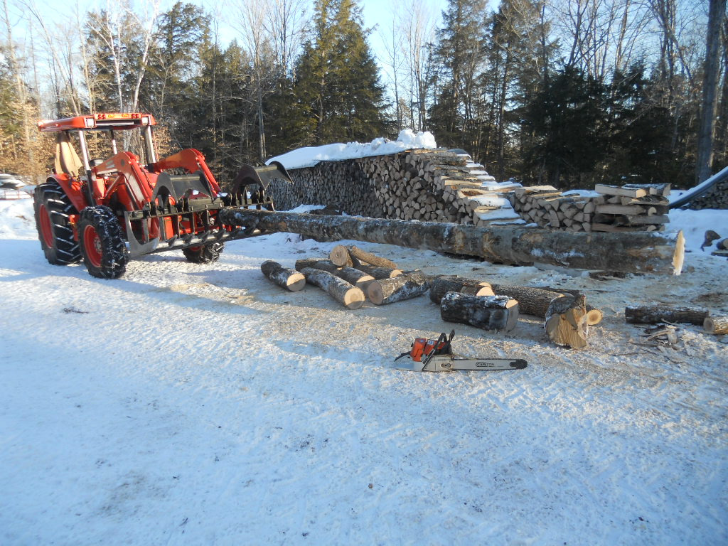

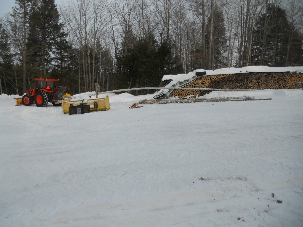

I cut the logs where I split & stack it. Sometimes handling it with the tractor grapple. I welded a heavy bar across the upper back (just under the hinge point for the "lids") that allows me to raise the whole log up off the ground to waist height to buck it to f/w length. If I have the loader off for snow plowing duties, I'll use the rear grapple. I'm thinning for firewood and all the stems are about 12" or less and would not be able to do this with bigger wood. Yes it is one log at a time, but I like to buck up a few stems, then split, then stack. I find it easier on my back & mind to break things up, a little saw time, a little splitter time, then a little stacking time. It also saves on steps taken working relatively small piles. When getting the wood out, I'll stack (loader grapple) it off the ground on logs in a handy spot, not worrying about processing it, that's a separate operation for me.
Like dickfoster said, a lot depends on the size of your logs.
