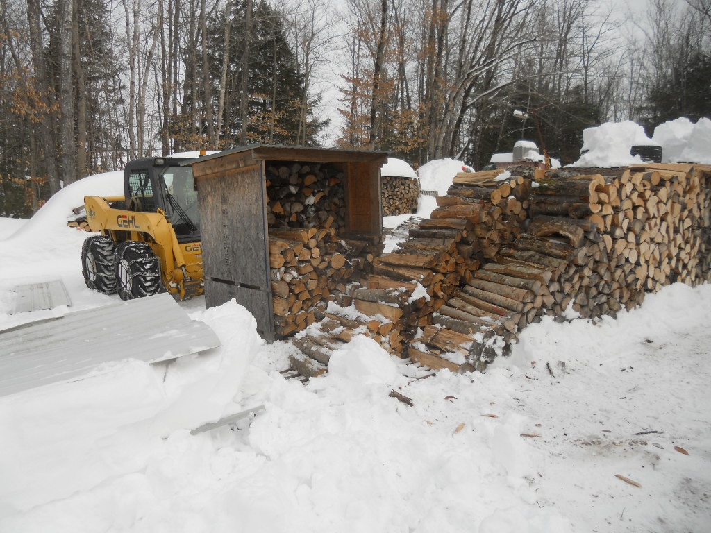

I'm just about convinced myself to build a bunch of them Rob. Do you stack right into them off the splitter to dry? That would be my plan, eventually I'd need a few dozen+. That sure would save a lot of time for me, by the time I need it, my stacks are under snow & ice, and a chore just to get that stuff off the top. I do top cover with old barn metal, but my stacks are 6' tall. The pic say's it all!:D
