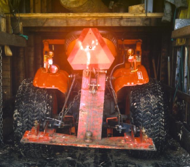

I have made a contrivance that attaches to the three point arms for towing stuff. It ain't pretty but does work.:D

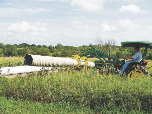

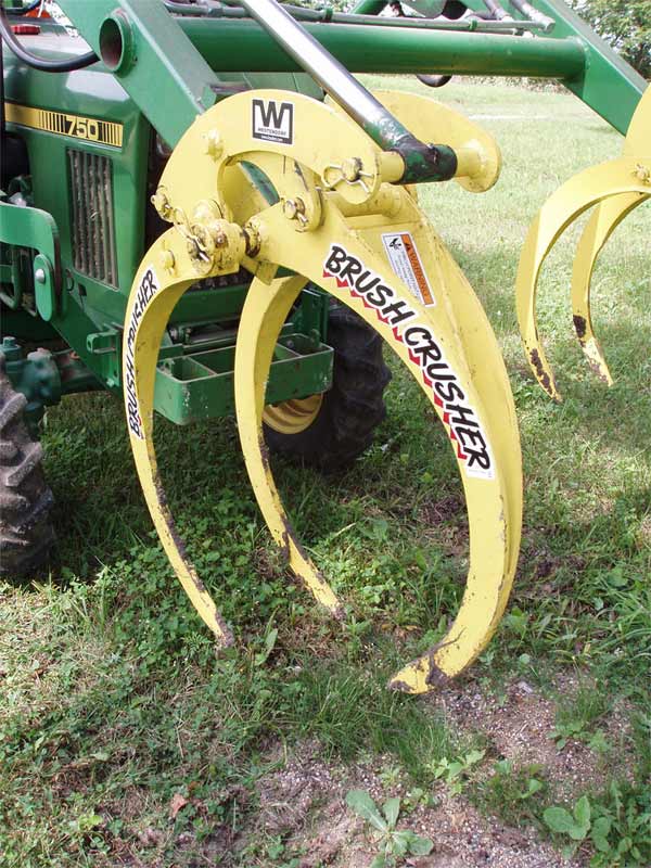

Westendorf-RR said:
These will make hauling those logs effortless - no trips of the tractor, no chains, less wear on your tractor and very economical since there are no cylinders to power the teeth. They work off the bucket cylinders on your FEL. Videos on Front-End Loaders by Westendorf: loader for tractor, shade canopy, wagons, manure & landscaping equipment.
I like the Edward Sissorhand claws.:D
How much is something like that? I visited your excellent web site but saw no price information.
   / Skidding logs #10
Since I am not sure of your loader model, I have based the fit on the HP of your tractor. You'd be looking at either a BC-3000 (around $850) or the BC-4000 (around $1,050). If you have a skid-steer adapter on your loader and want to use that, there is a unit with hydraulic cylinders (BC-7000 that is around $2,200) then you'd need an open hyd. port on the tractor.
