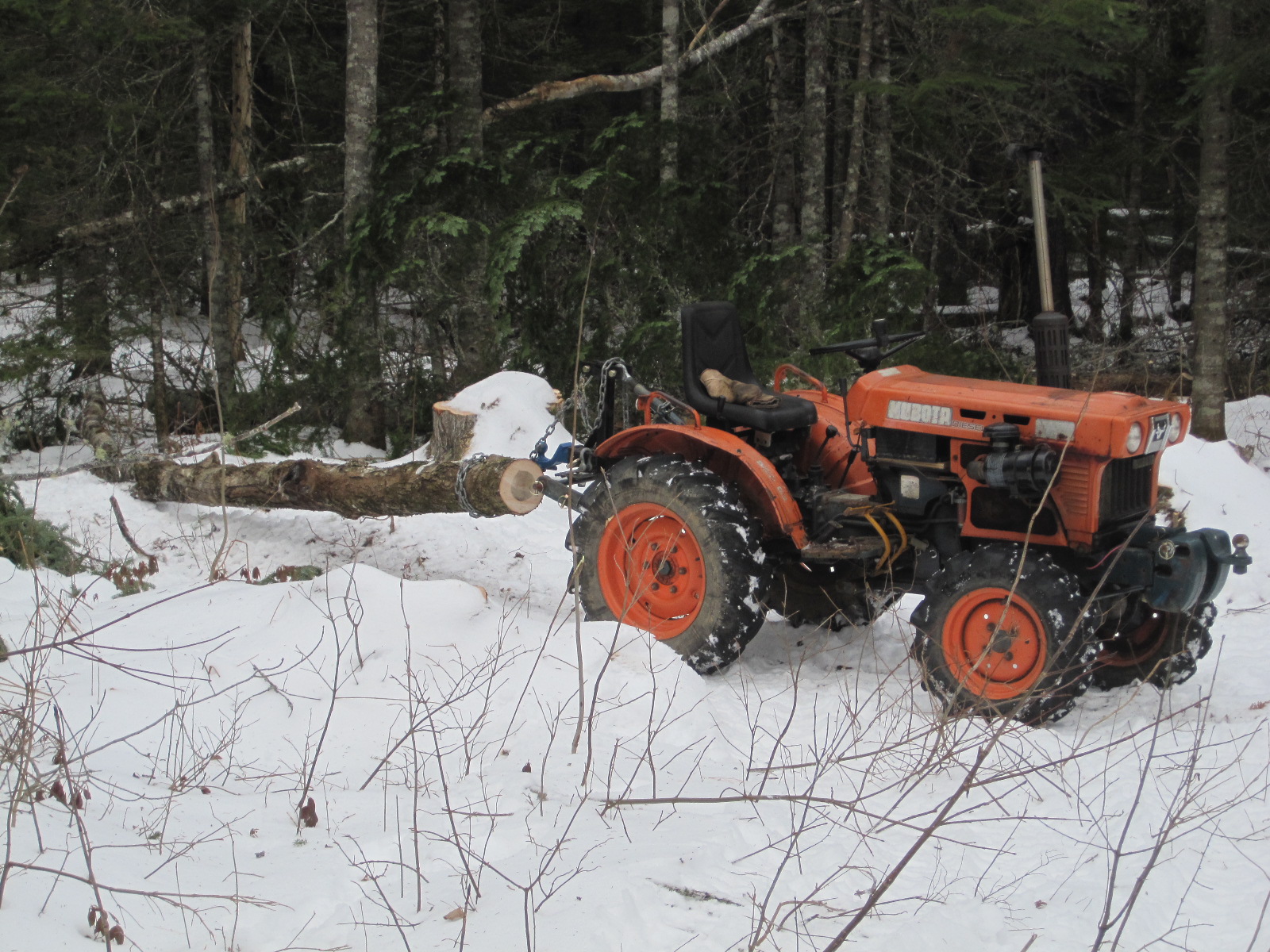

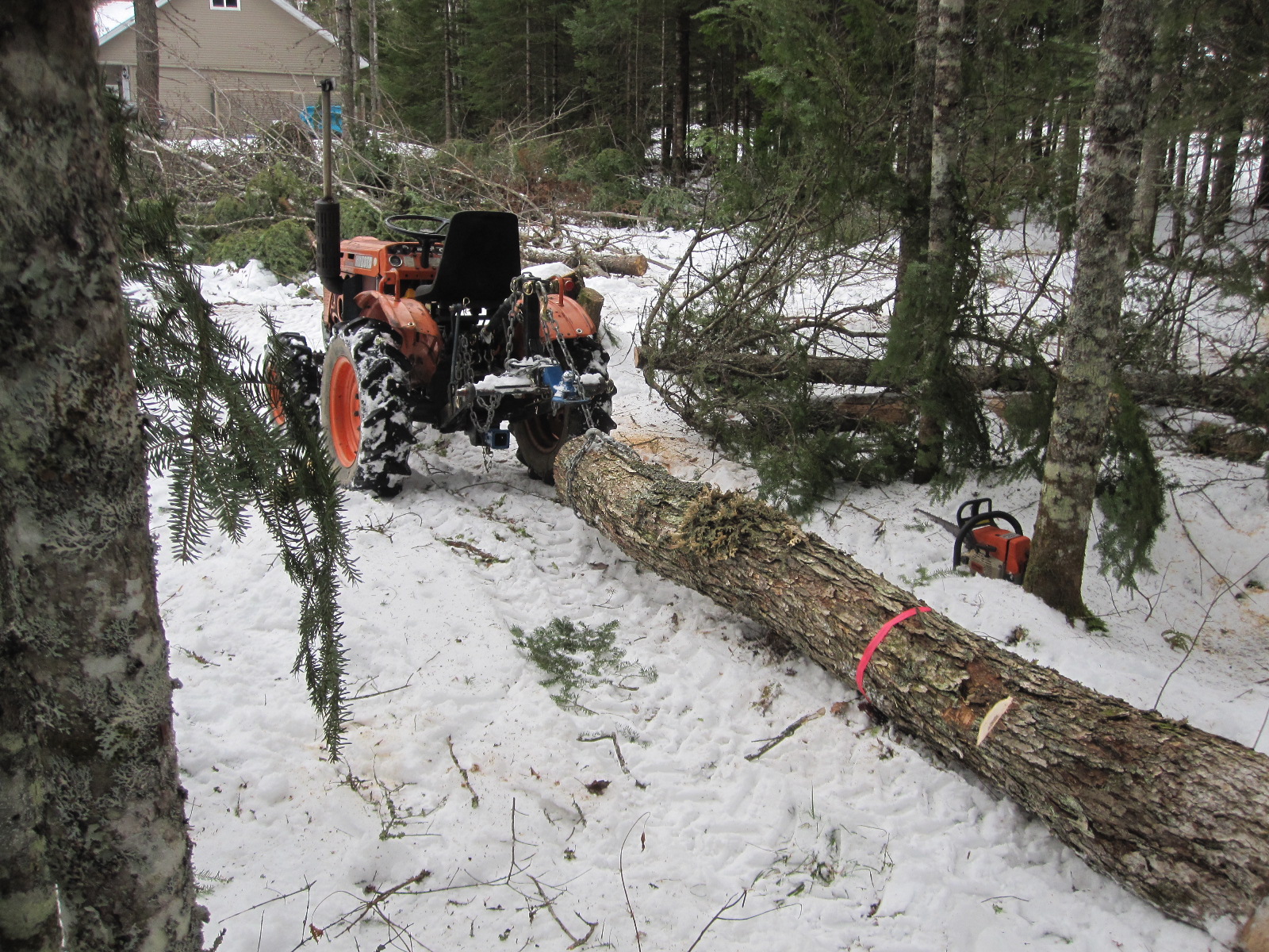

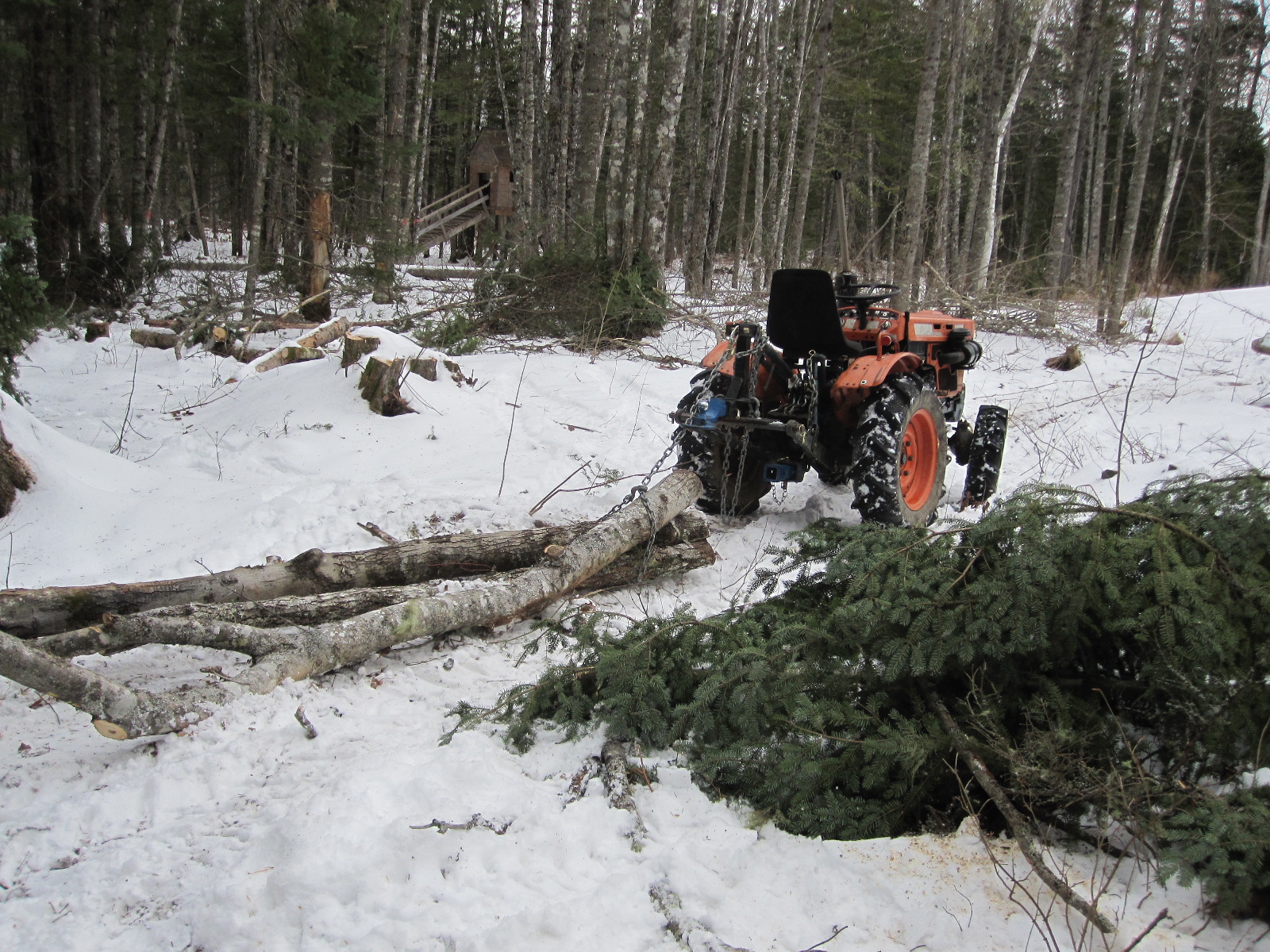

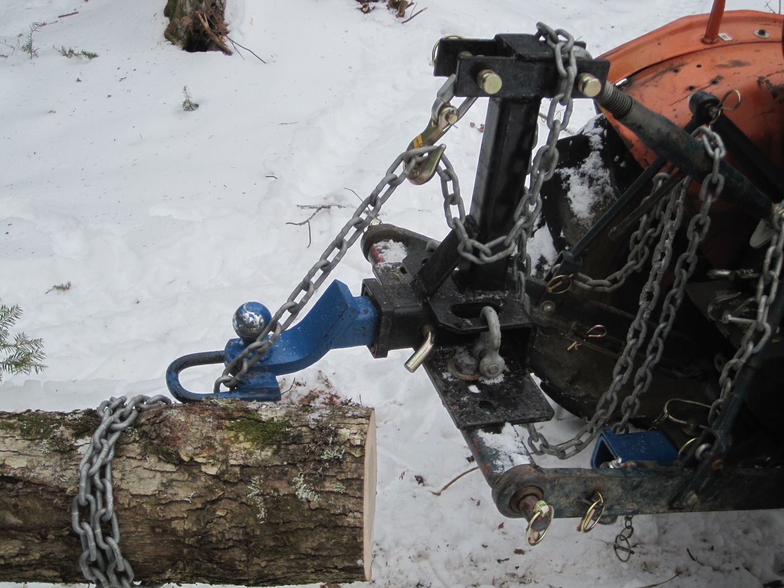

I have a 1980 B7100 with 2900 hrs. on the clock. In January (coldest snap we had all winter!) I cut & skidded out 5 cord of Maple logs for firewood, on a lot a guy wanted cleared. Cold enough that the boggy ares were frozen & about 8" of snow to help skidding. I welded up the trailer hitch/skidding attachment that bolts to my 3 point draw bar & used a 12', 5/16" galv. chain with a slip hook on the log end as a choker. The chain went through the loop on the hitch & fastened to a grab hook where the top link attaches (might work even better if the hitch with the loop was shorter so the chain was more vertical going to the grab hook at the top). Lift the log with the 3 point hydraulics & take off in 1st gear, 4wd. Biggest log was 16" & 12' long. Tractor was amazing - small enough to go anywhere without cutting roads & lifted/hauled everything I cut. Never once attempted to lift the front end even when log got hung up. I have (2) suitcase weights hung from the front bumper. It even started easily in -18C since i replaced the seized decompression cable. I had to climb a small hill approaching my dump area, so I would give it lots of throttle approaching the hill & stand on the diff. lock. Hardly any wheel spin but by the time I neared the top I would use the brakes to steer as the logs would roll a bit & try to pull me sideways. Had a ball.
