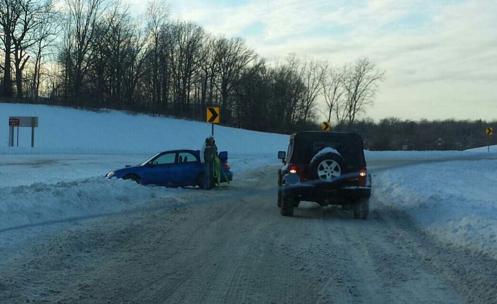

Ill wager you wont find a Subaru driver in any of those "displays".
larry
No you find them needing assistance from a jeep and a tow strap :) pretty typical. Driving 12 tenths of their own ability at about 3 tenths of what the car is acctually capable of
   / skidding on black ice
#96
too funny, a WRX STI, yeah, he wasn't pussyfooting around. I sure hope he had winter tires on at least; that thing comes with pure summer tires.
   / skidding on black ice #97
I'm sure he thought he was ken block right up until the point i watched him stuff it. He had a snow shoes on i did get a look at the tread blocks as i drove by him
#98
well you really have to be hotfooting it to stuff an awd car with snow tires on a somewhat plowed road like that.
At least snow drifts don't sue...and often only hurt one's pride.
I bet he just stuffed too much snow underneath and high centered.
