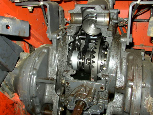

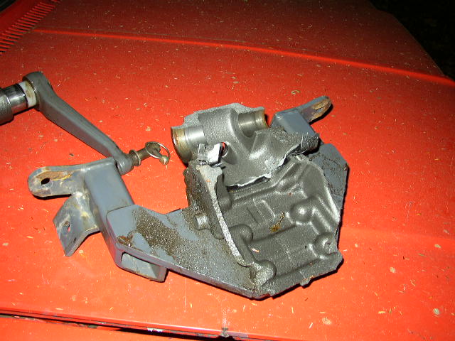

Below are some pics from 2004 that show what can happen to a L4610 if your good advice is not followed - in this case traveling uneven terrain with hitch choked up short. Luckily only the owner's tractor and checkbook were injured.

Incredible pictures, also, thanks for sharing them. I'm gonna save those for the next time I'm feeling sorry for myself about parting a cable or bursting a hose. Just curious. . .do you know if that hunk of the axle case was PULLED out from the root of the top link, or RAMMED back in, to break it out like that?

It was pulled. There were several logs drawn in tight and winch was lifted. Going up over a rise, the front wheels started down, and the top link and gear case broke out. There's a 3-page thread here from 2004 - pics don't display now but I have them if anybody wants them. Also in that thread are two great extended posts on skidding written by Bob Mayer, an Indiana silviculture expert and TBN member since the beginning.
