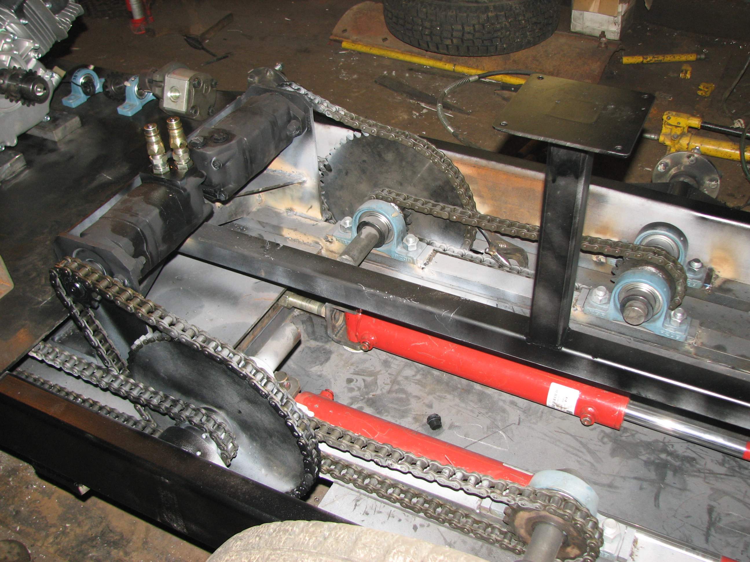

   / skidhoe
15hp gas and 2 hyd pumps chain drive hyd motors reduced 6 to 1 driving each side goes through a gear splitter 18 gpm and a 9gpm split to the boom and the blade 9.5x30 tires on 15 inch rims planing on adding tracks before spring it can push 1250lbs of steel on bare ground like its not there [a bundle of 8 inch channel iron] so the tracks are mostly for xtra flotation. 13foot4 reach and 185 degree slew i can pick up 200lbs at full reach so the 15 inch bucket should never weigh that much full of dirt. the thumb is run by a 2 inch hyd cyl and folds right up against the dipper. when the stabalizers are right down the tires are 15 inches from the ground and the blade goes down enough to keep it all level i only need that much travel doing beaver dams were its rough

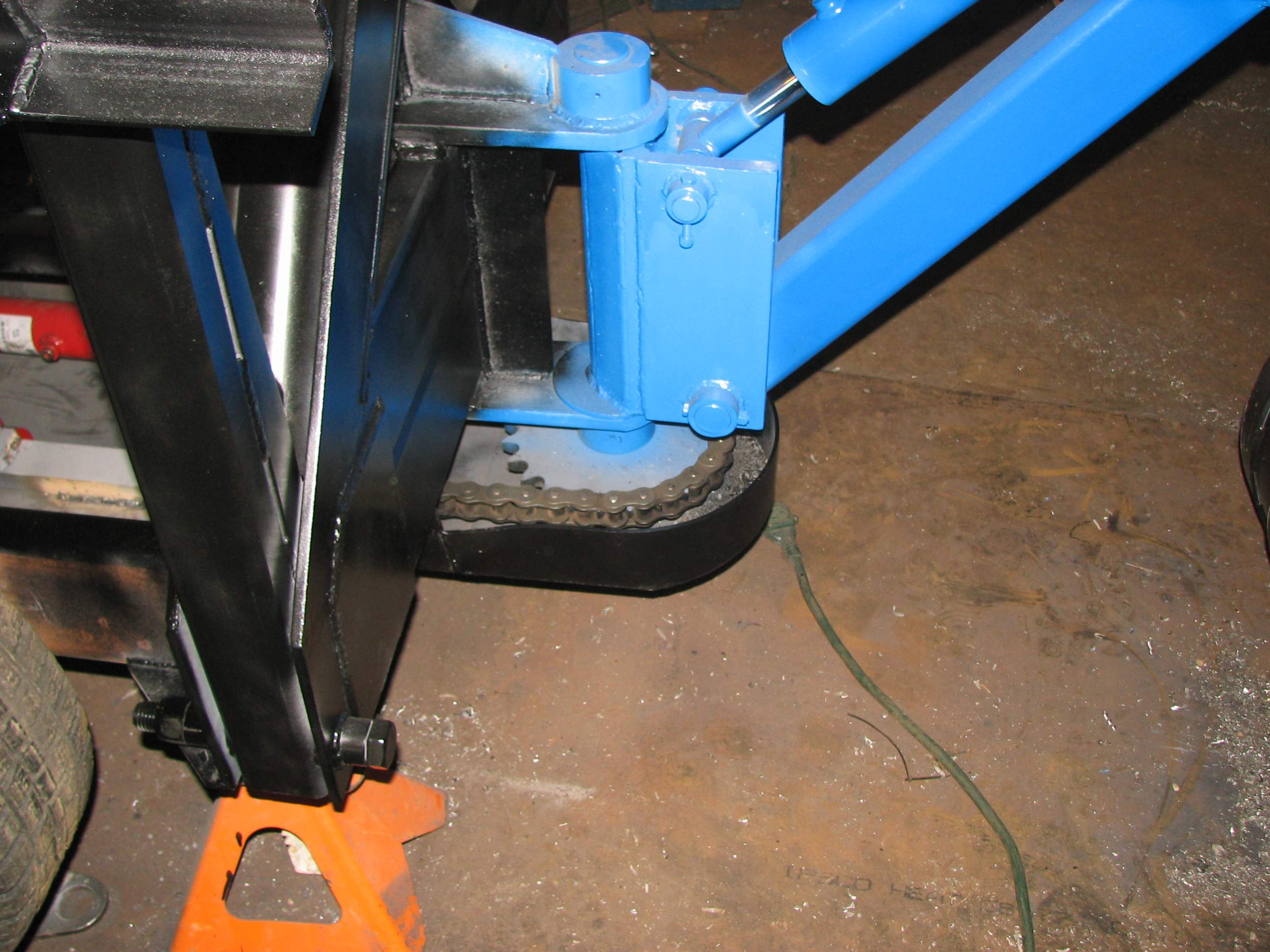

this is the slew 100 r0ller chain and 2 hyd 2.5 x16 single acting cylinders i can pick up the skidhoe and move it around very easily from side to side the swing works a lot smoother when its not minus 24 lolIMG_2224.jpg

the chain drive system going to change the final drive chains to 100 roller as i broke one of the heavy 60s when i had a set of tire chains on so they might give trouble when i put on the tracks no trouble without the chains on thoughIMG_2223.jpg

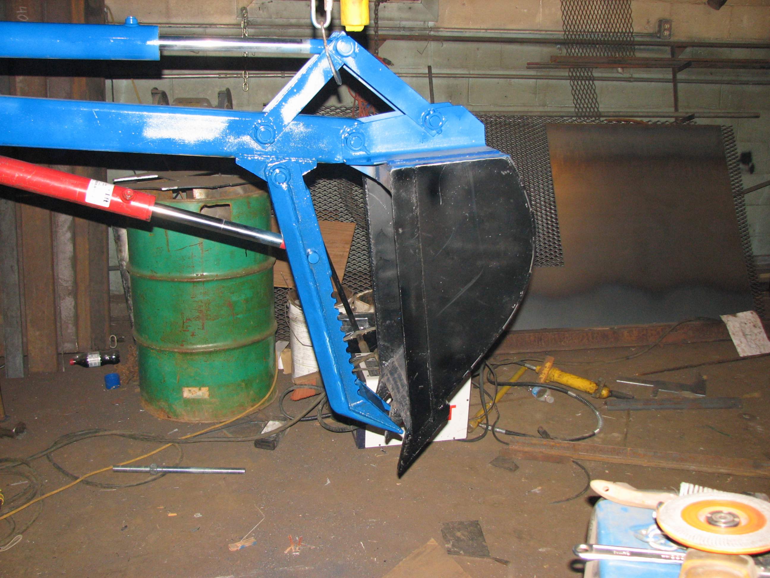

#11
15x24 bucket teeth are cut out of 1 inch mildsteel and hardsurfaced bucket is 1/4 plate as are all the wear platesIMG_2194.jpg
   / skidhoe #12
VERY NICE!!!! Can you prettty please get a upclose picture of the pivot point?? I am really, really curious how you got your done!! Did you use the chain roller or what? I have a backhoe in my backyard but I am seriously consider building my own portable backhoe and then sell this one because I bought large land in Maine and I don't want to have to invest my money into dually truck and trailer suitable for 10,000lbs backhoe. The road toll would kill me! :eek:
Also, I am intriqued how you managed to get one motor to run two hydraulic pump. Did you use chaindrive to two pumps?

   / skidhoe
#13
hi i direct drive one pump i made my own pump bracket so i could have a40 chain hooked to a sprocket behind the lovejoy and that drives my big 60gpm pump( scavenged from a semie) its reduced 3 to 1 so i can only get about 18 or 20 gpm but i seem to get a lot more torqe i have 2000 series hyd motors 6700 inch lbs at 3000psi im only running them at 2000 then reduced 6 to 1 the motor never changes sound even spinning around on pavement but its only 2 mph thats enough to move around in the yard or bush and at 3500lbs you can use a carhaller to move it i will get a pic monday and post it for you
