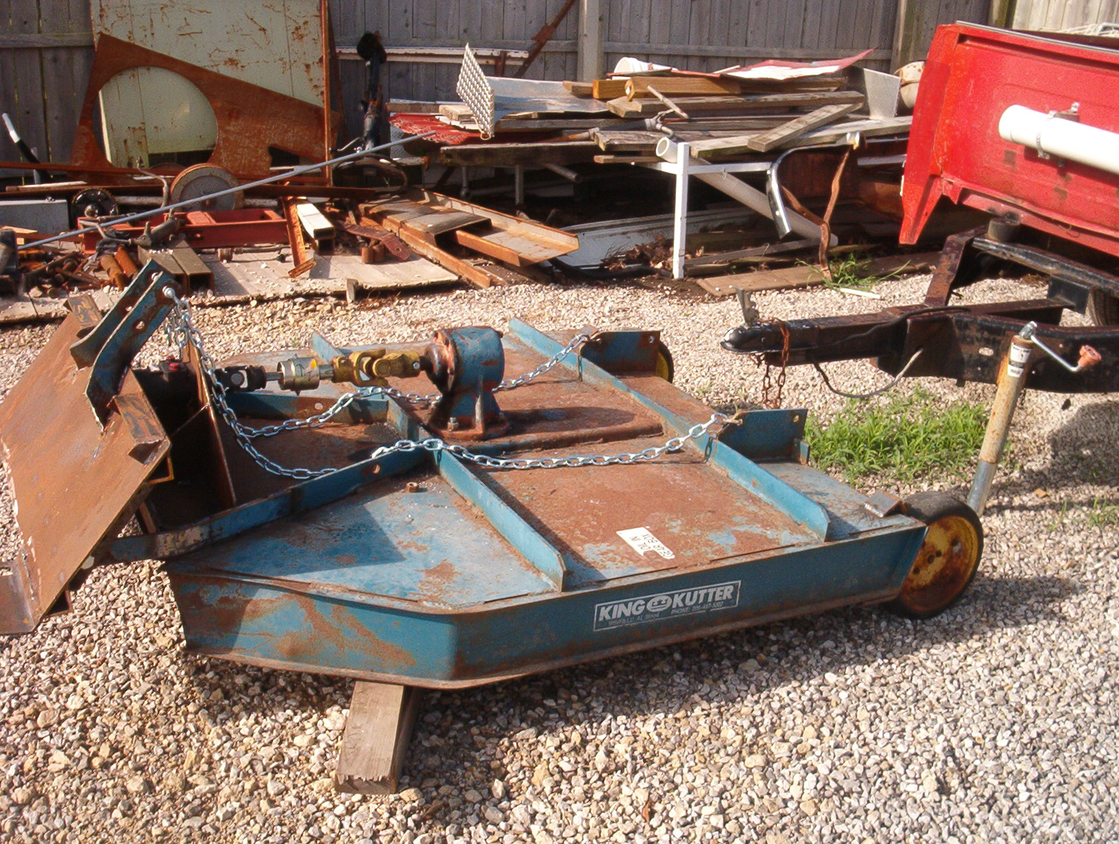

Here is the only pic I have of A front mount mower I built for A buddys 1840 case uniloader.Started with A $200 3pt king cutter.I turned the gear box to face the rear & mounted A hydraulic motor from surplus center.We built the quiktach mount plate out of 3/8.It's not done in this pic, I added A pto cover made from 6" pvc pipe.He's used it one full season to mow road ditches & clear brush.Next project is A front sickle mower for the same guy.I will take & post pics as I go.

And I thought compact tractor was the only way to go for versatility. I'm learnin there isn't much you can't do with a skidsteer.I'll be interested in the sickle bar project, I drug an old model 120 NH out the brush on my neighbors lot and fixed it to mow my food plot. I have about 300 bucks in it.

WOW,Thats kinda over engineered ain't it?
/ Skidsteer mower #7
Yes but the big plus is, it will run 3 PT stuff not just one, I fell in love with this one

Yep, thats things A monster ain't it? I'll get some more pics & post em. Mike

It is a nice mower, great way to spend eight grand to mow a couple of empty lots...

Interesting concept. I have two thoughts though, which is more than I can usually claim to have at one time.
1. Does it matter that instead of pulling that mower deck, which is the way it was designed, it is now being pushed against those trailing casters?
2. My experience with skid steers, limited as it may, is that when they turn they tend to "skid" their tires, thus possibly doing damage to the turf. I had to do some serious repair on the grass at one of my homes because some skid steer jocky thought it was cool to whip that puppy around spinning the tires, just ripped the heck out of the lawn . . . took months to settle with the contractor. Then I suppose this is really not the type of implement you would use on a regular lawn type yard, but more for a pasture where the grass is more course and left longer.
Pretty creative anyway you look at it. Am certainly interested in seeing more pics.
/ Skidsteer mower #11
Just watched the skid steer mower video at Mr Jimi's link. Darned impressive piece of equipment. One could have a lot of fun for $8K with that baby.

Olmike,
I am looking for a 3pt flail mower to convert for use with my Toolcat. I plan on fabricating a set of caster wheels for it and an attachment plate that oscillates so the mower can follow the contour of the ground. The Bobcat finish style mower I have does this so I have a good model to work from.
One concern I have with converting a 3pt PTO to hydraulic motor drive is determining the correct output shaft rpm. How did you determine what motor to buy?

dsb,The owner called the tech line at surplus center. He gave the hydraulic specs for his machine.The motor is aprox. 500 rpm at full throttle.Just right for the mower.I put an overiding pto clutch in the short pto shaft to take the shock out of drive line when you cut off the oil flow.Mike
