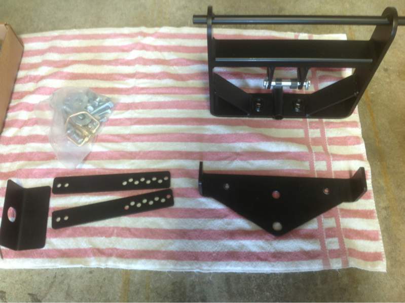

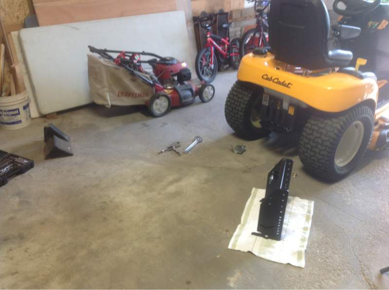

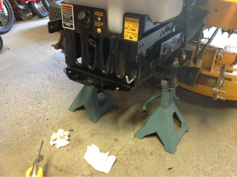

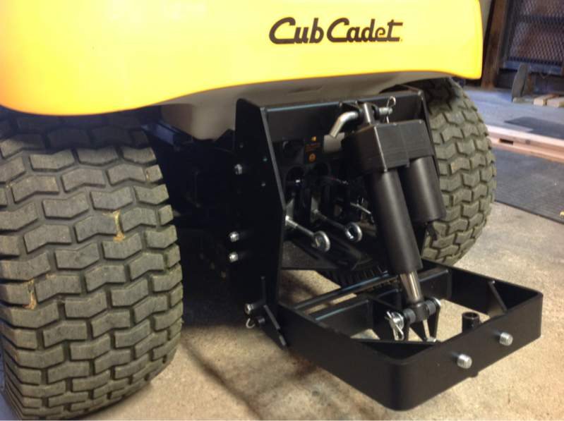

I have a 2011 Cub Cadet GT2100 and I just installed the "Johnny Products Universal Sleeve Hitch" and I am beyond pleased with it! It certainly is not the least expensive option out there but it is built with heavy gauge lazer cut plate steel and has a 500lb dynamic, 2250lb static load electronic actuator. I use it with my brinly cultivator and box blade, the down force for the box blade is almost essential for effectiveness. See photos of the install and set up.
I moved quote a bit of dirt with it for my latest landscape project, I would break the soil up with the cultivator then switch to the box blade to move the loose dirt. I repeated the process many times and created terraces and berms on the hill in my back yard.
Now, as others mentioned if your machine is not rated for use with ground engaging equipment and you attempt this you may fry your tranny among other things.
But if you use your equipment within the designed parameters the sleeve hitch will be quite useful, again, the electronic actuator is worth the extra money.
