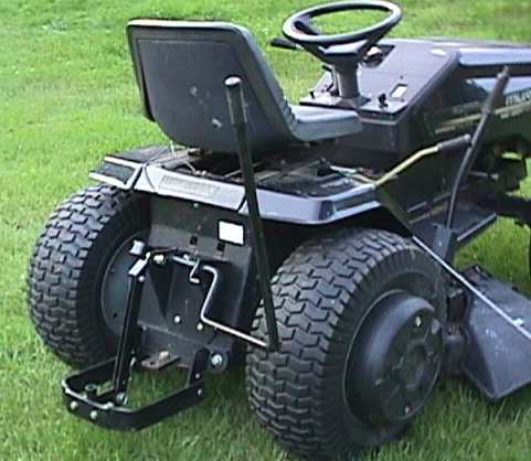

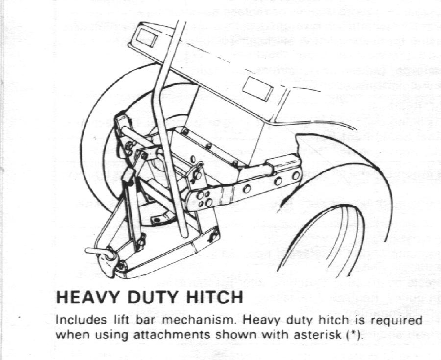

good info... Thanks all for the input. But wait.. one more question. I recently read (not sure if it was here or on a garden tractor site) that you can't have the sleeve hitch and the mower deck mounted at the same time???
this sound familiar to anyone?

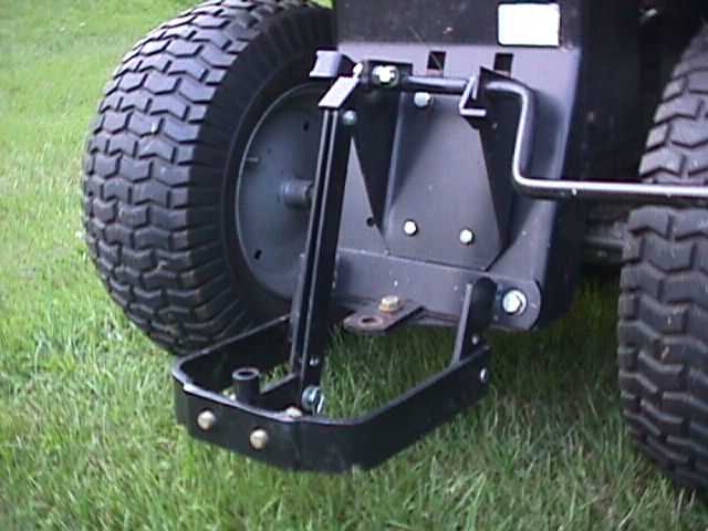

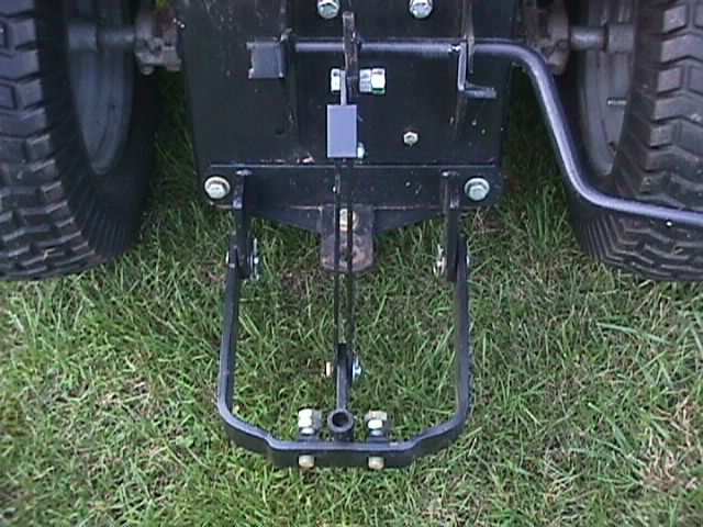

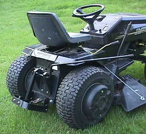

That's false, at least with my tractor. The hitch bolts to the outside frame at the rear and in no way interfers with the mower deck or controls.
Just wish that I could find some attachments.

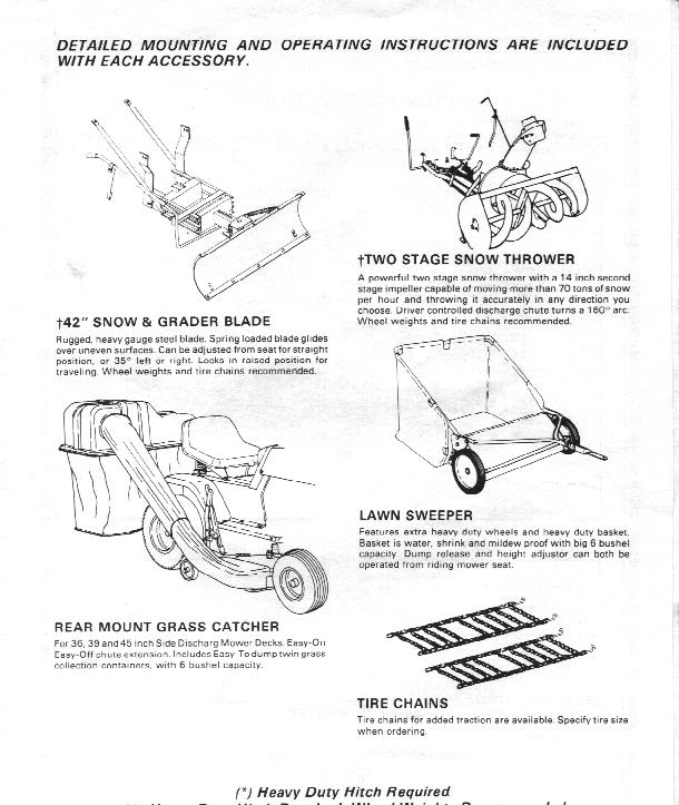

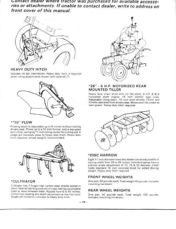

Just go to the Agr-Fab site they have quite a few attchments available. http://www.agri-fab.com , most of these can be purchased through Northern Tool or most likely a local farm supply place.
/ Sleeve Hitch #24
Thanks for the info. I have the red 10 cu ft dump cart. The sleeve attachments are available at Sears, they even use the same pictures.
