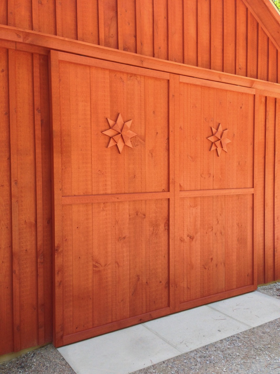

That's just the frame in my pic -- aluminum tube on the sides and 2x4 fir across. Here's the finished doors with pine siding and stain:

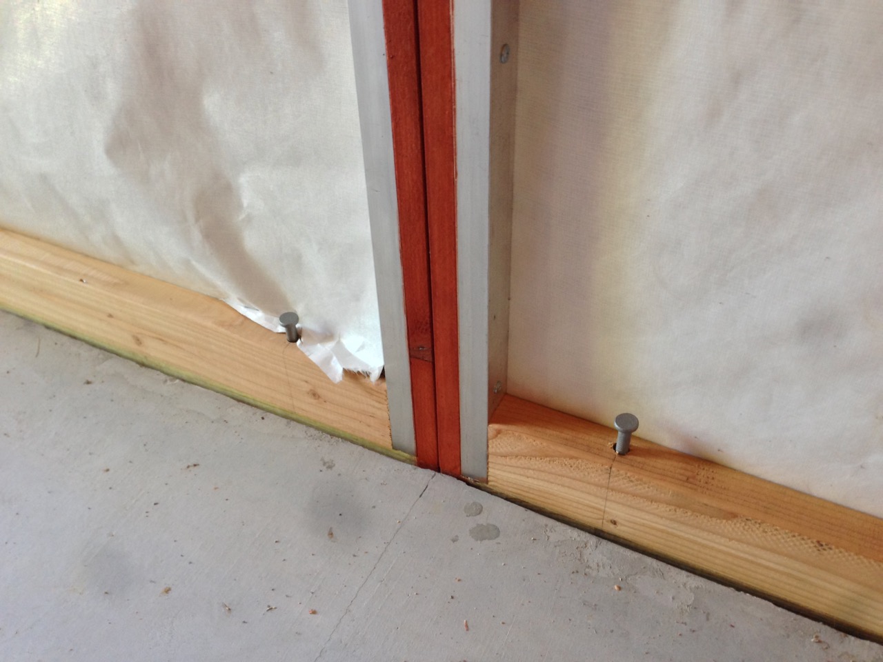

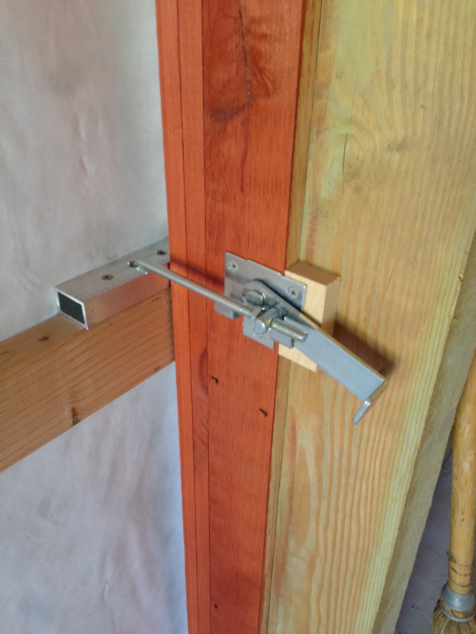

I used spikes on the bottom as pins, as well as latches on the sides, to keep the doors put when closed:
