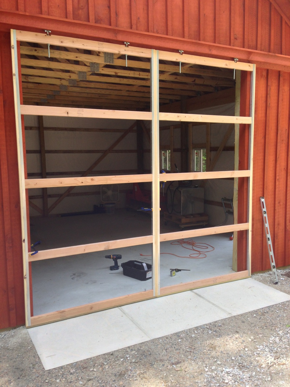

Can anyone show me a plan for building a frame for a metal clad sliding barn door? Door will be 12ft wide by 10.5ft high
/ Sliding barn door #2
Typically the doors are made from a frame of 2 x 4 or 2 x 6 material lying on edge so that they are thinner. Metal plates are used at the joints to hold the pieces together, then wrap the topedge (to protect it from the weather) and cover the outside with tin.
/ Sliding barn door #3
build it out of square tubing. it won't sag and will be lighter. make a rectangle and 2 pieces cross ways
/ Sliding barn door #4
When I made my barn doors, I used 1"x1.5" aluminum tube for the verticals (one on each side) and 2x4 doug fir lumber for the horizontal pieces across (spaced the same as the wall girts). I just didn't trust a long 10' piece of lumber for verticals to stay straight. SO far the aluminum has worked very well.
Here's a pic of the two door frames hanging in the track and aligned up, right before I attached the siding. You can see the aluminum tube verticals if you look close.
