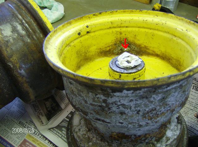

Using "slime" as a general term, some liquid sealants can rust rims as bad as CaCl. I have a 420 JD (garden tractor) that had a front tire leak when I bought it. Took it off to find sealant in it with a badly rusted rim including a pencil lead sized hole! Cleaned it, epoxied the hole, repainted & used a tube in the new tire. Cured me of using liquid sealants! Just had a front tire on my 790 cleaned, patched & tubed today because of the stuff! ~~ grnspot

what problems have you seen with this?
most slime products are 100% water based, ( with suspended particles ), and can be washed out, and then have the tire casing cleaned around the patch area with solvent.
I'v applied inner- patches to tubeles tire casings on many occasions after a slime product was used to limp it for a couple years.
after washing the casing out with soap and water and then dried, I cleaned the patch area with a solvent like hexane or 3m adhesive and wax remover.. makes a nice surface for a patch. used regular flat / round farm and or 'bike' style patches ( red backed ) that you use the can of rubber cement to stick them on with, not the adhesive backed patches.. etc.
have yet to have a failure of one of those patches. ( fingers crossed / knocking on wood now ) :)
