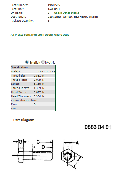

My guess is if shaft leading to slip clutch is a telescoping type then the sliding section needs some "lubrication"!! Below is spec's on bolt I located in MX10 PC.
