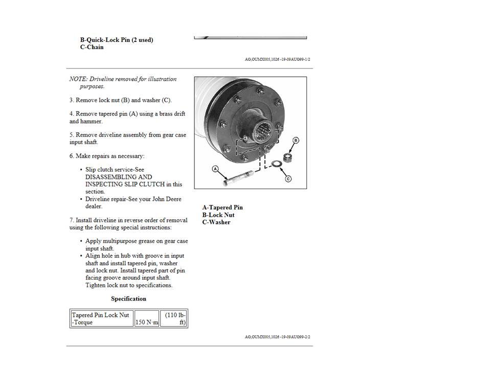

Regardless; plenty of good thinking.
,,,See Egons link and see what you think.
I'd say Egon's link clearly shows a tapered pin and I think you're correct: that taper pin is called out to retain and immobilize that joint.
So did a tapered pin get used to secure the collar, or was it secured with a plain bolt?
Just looked at the OP's first post, with picture of the plain bolt, so it would seem we have the smoking gun.

WE used JD bolt listed in my reply (#11). Definitely not tapered. Will communicate this with mechanic helping me. I'll let everyone know how it goes.

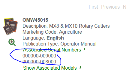

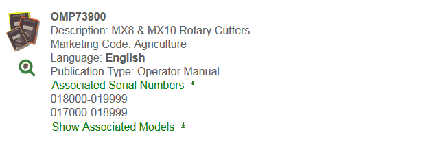

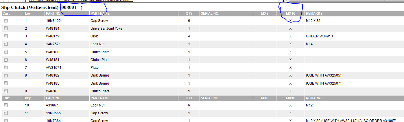

I'm curious to hear what the serial number is of AgMan's MX10. Note the serial number in Egon's operators manual link goes to <-8000 on a MX10. MX10 parts catalog lists a capscrew after serial number 8000.

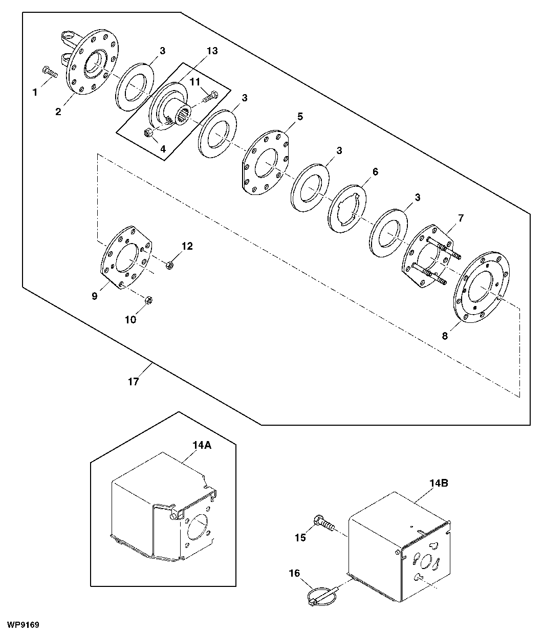

Here's what the parts catalog shows be it a ""down or up grade"!!!!!!!!!!!!!! Be sure to closely inspect parts keys 4 & 11.
Without a close inspection of 13 and the spline shaft were still nowhere.
,,, Soley from the picture Id say its a downgrade because it looks as if 13 is not clamped by the bolt. Nor is there an apparent grease fitting on it by which to maintain and damp the, then floating, joint.

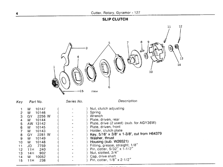

,,,My 53 yr old JD 127 Gyramor has a rigidly attached slip clutch. The bushog has been used long and hard and no attention to the slip clutch other than adjustment/preload has been needed.

Your JD 127 was built along time ago and I fail to see the slip clutch similarities to a MX10. I've seen a lot of slip clutches that aren't clamped to the gear box input shaft.
