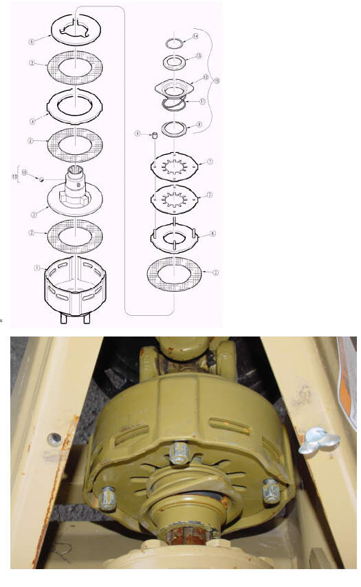

John,
On the thought that one picture is worth a thousand words, here's two (combined). The exploded view is from LP's web site. The photo, I just snapped.

Hoss
That is the same slip-clutch that I have on my <font color=orange>Kubota</font color=orange> Tiller. You are right; tightening the nuts down will release the pressure. It looks like you also have the 1 3/8" spline coupling that mine has. This will allow you to remove slip-clutch and PTO shaft from your tiller. Sorry for the confusion.
