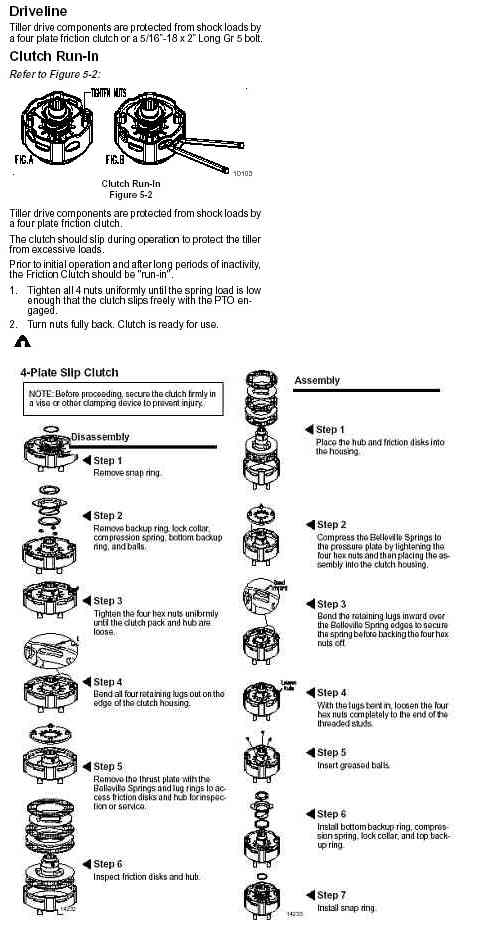

Terry,
Here's the relevant stuff from the LP pdf file.
Hoss
   / Slip clutch -- winter storage #12
CV,
My tiller manual reads the same as yours. I guess it should since there the same brand. I release the presurre for winter storeage and when spring rolls around I will slip the clutch before I adjust it to make sure there not stuck together.
