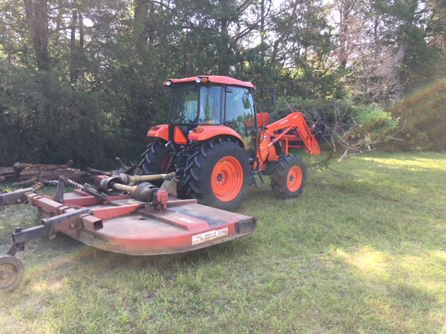

Old news: Slip clutch on Bush Hog I inherited probably has not been "slipped" in many, many years.
I tried loosening the nuts a couple of turns, still wouldn't slip. I asked about what to do here and got a number of replies similar to: "Rev it up and drop it on an old stump"
I had fear that it was really bound up and I didn't want to risk damaging my tractor PTO. Turns out I was right.
I took it apart today. All 4 fiber discs were corroded and stuck to other parts. I had to use a screw driver to get them separated. I cleaned the metal parts with a chisel, followed by a wire cup brush on an angle grinder.
All 8 bolts were rusted and would not turn with a wrench. The DeWalt impact wrench freed four of them then broke one in half. For the last three, I screwed a nut on and tapped with a hammer while using the impact wrench. I drilled the broken one.
I'll probably replace all 8 bolts. I suspect (hope) the 8 springs are still good. I'll get four new fiber discs (local dealer has them and they are not expensive) and reassemble.
I enjoyed an afternoon of figuring out how things work.
I post this for anyone else that might be in a similar situation. I doubt my clutch would have ever slipped.

Your approach is the only one that has ever worked for me. The last time I found only one or two surfaces could still slip and the other surfaces had bonded hard.

Got the slip clutch back together and the cutter is working well. I thought I had the correct part numbers for the fiber discs. WRONG! So, I took the old ones in and compared. Our local Kubota dealer also deals Bush Hog eqpt. They have a guy in parts that goes out of his way to help. He has even taken the time to explain how to do things to me.
I really like this offset cutter. Leveling it can be a chore. I have to put blocks of wood under the right side so that I can shorten the right lift arm. I'll be looking forward to getting a hydraulic top and tilt to make it easier.

Gale, my Bush Hog is 10' wide. My tractor is a little over 6' wide.
The Bush Hog cuts behind the tractor and about 3.5' off the right side.
Makes cutting around the pond and along tree lines much easier.
