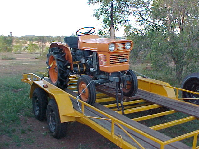

Well guys it turned out to be a real easy fix !
Stupid here carted his tractor on a hired trailer about 40km, got it off the trailer and into the mechanics this morning. The reason for the lack of lift.......... The lid of the toolbox under the seat had come adrift and was fouling up the lever. Felt like it was right back but it was hitting the toolbox.
When fixed !! The little machine lifted me and the mechanic, over 200kg so I reckon it is now OK.
Learned a lot from him anyway, besides how stupid I am.
Attached is pic of the 'Bota on its way anyhow.
Fun stuff !!!!1
Neil R.

#18
Here is the missing pic
Neil R.

Neil,
Glad to read the good news about the fix.
Most of the times its the easy fix that makes one /w3tcompact/icons/crazy.gif for we all been there a time or two. /w3tcompact/icons/wink.gif
Nice looking trailer...did you make the trailer yourself.
Have a pleasant weekend.
Thomas..NH /w3tcompact/icons/wink.gif
