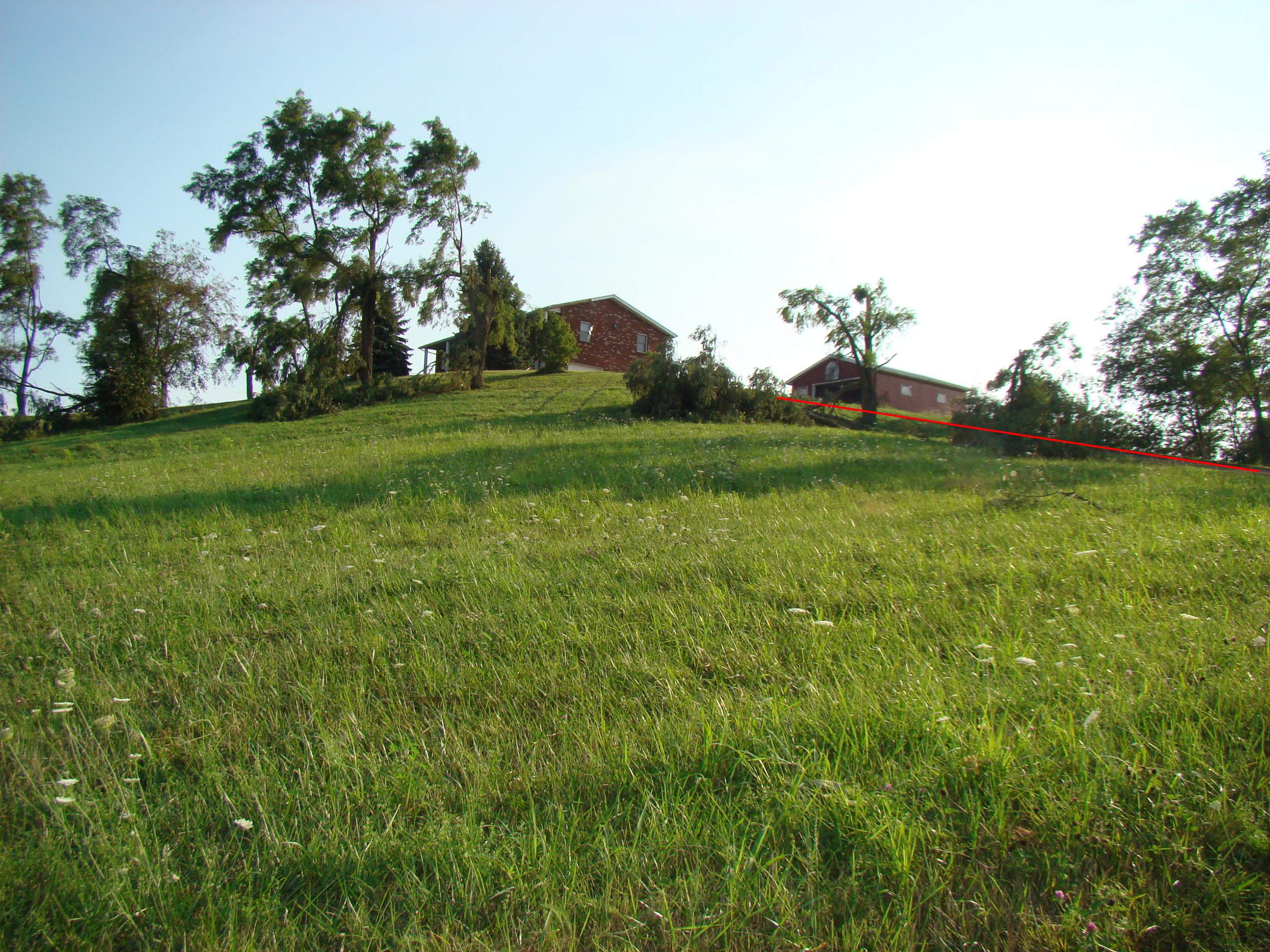

This isn't a good picture, just a shot of some storm damage a couple years ago. The red line represents the driveway, approximately. It actually get's a good bit steeper at the top, but even the red line is beyond 15%. The biggest challenge for me is heavy snow. You don't have to worry about that, so you'll just have to deal with heavy rain. The biggest thing is to have a good base and have it sloped to the side so water runs off into a ditch quickly, rather than down the middle of the driveway. Other than that, it's just a matter of smoothing with a back blade on occasion. Visitors don't like it, but I figure it keeps some of the undesirables away. :D
