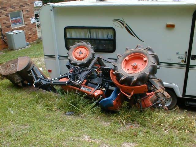

See my post in Saftey, "A bad Saturday Afternoon"
A combination of a slight slope, two ruts from the power company truck, an unbalanced load, and other factors...
My dad was the operator, new (to him) tractor, had it on the ground less than 15 minutes. It scared him enough that he hesitates greatly about using it anywhere other than on perfectly flat ground (and nothing's flat around here)......
A bad Saturday afternoon

Mike Z,
I had not seen that before.
Thank you for pointing us to it. Sure will keep your experience in the back of my mind and it will help me to be a safer and more cautious tractor operator.
Glad you are still with us...
