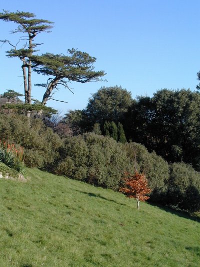

Better picture of my slope. Any comments on the suitability or otherwise of using the BX2200 to mow this would be much appreciated.

The safest way to mow a slope is drive down, back up...
From your profile : <font color=blue>UK, south coast, on a cliff </font color=blue>
Better make sure you have good brakes!!!! /w3tcompact/icons/wink.gif

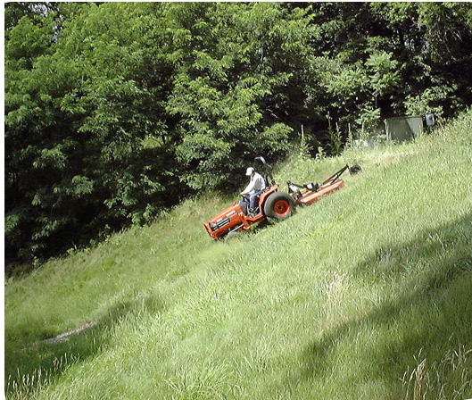

Should be fine going up and down the slope. Attached is a photo of me on by B2710 cutting the one of the hills at my shop. I wouldn't try doing it side to side, but its not bad up and down.

I think its an Austrian/Scots pine (Pinus nigra) - they go flat topped when mature (50 yrs this one - planted by a guy called Eric Williams who wrote 'The Wooden Horse' - you've probably seen the WW2 escape film)

Steve,
I turn around at the bottom, drive straight up and then turn around at the flat on top and drive down.
   / Slope #9
I suggest you measure your slope with a standard carpenter's protractor available from any hardware store or use a Tiltmeter. Most compact tractors can operate on side slopes of somewhere between 15-20 degrees. It depends on the tread width, surface roughness, turf wetness, travel speed, other equipment on the tractor such as a loader, etc. You can find many other tractor owner comments on this board about their experiences in operating on slopes. Many express a high rise in their "pucker factor" on slopes of 15 degrees or more.
