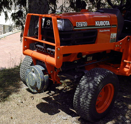

von and steve : those are quite some slopes. do u have weights on the front to keep her down or is the slope not as bad as it looks?
   / Slope #12
Frank,
I bolt two old wheel weights to the front (about 100lbs) they help, plus my rear tires are loaded. I have no problems as long as the rear tire of the mower is also on the ground. (see photo attached of weights)
