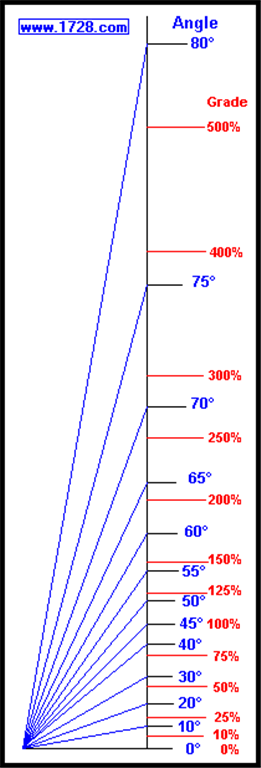

The garden tractor at 40% isn't exactly what I'd call safe. Doable with caution sure but if you find a hole that use to have tree stump in it you suddenly you pick up 10 degrees. 40% is about 22 degrees, tack on 5 or 10 degrees for safety and you are talking about a 50-60% slope. See Slope - Degree, Gradient and Grade Converter for a nice table that goes both ways. I think their ad is correct, 40% slope is all I'd want the liability for. 40 degrees equals 84% slope would you want the liability for that? Let someone take it steeper if they think they can but I wouldn't call it safe for advertising purposes. What does JD advertise as safe for a garden tractor?

Agree with most of what you said ... BUT GOOD GRIEF !! "Using the % key because you don't have a degree key" is equivalent to saying you don't care if a comment refers to 40 degrees or 22 degrees (since 40 percent slopes are roughly 22 degree slopes.) I originally thought you were just joking. Worst case you can spell out degrees and percent as I just did above.
By the way, there was a great post a week or two ago that pointed to the Grade (slope) - Wikipedia, the free encyclopedia website. This has the best comparison I have seen between percent and degree of slope. Has the formulas, the definitions,etc. too. For those less math oriented, that graph that shows degrees overlaid on top of Percent slope is a terrific tool/illustration.
