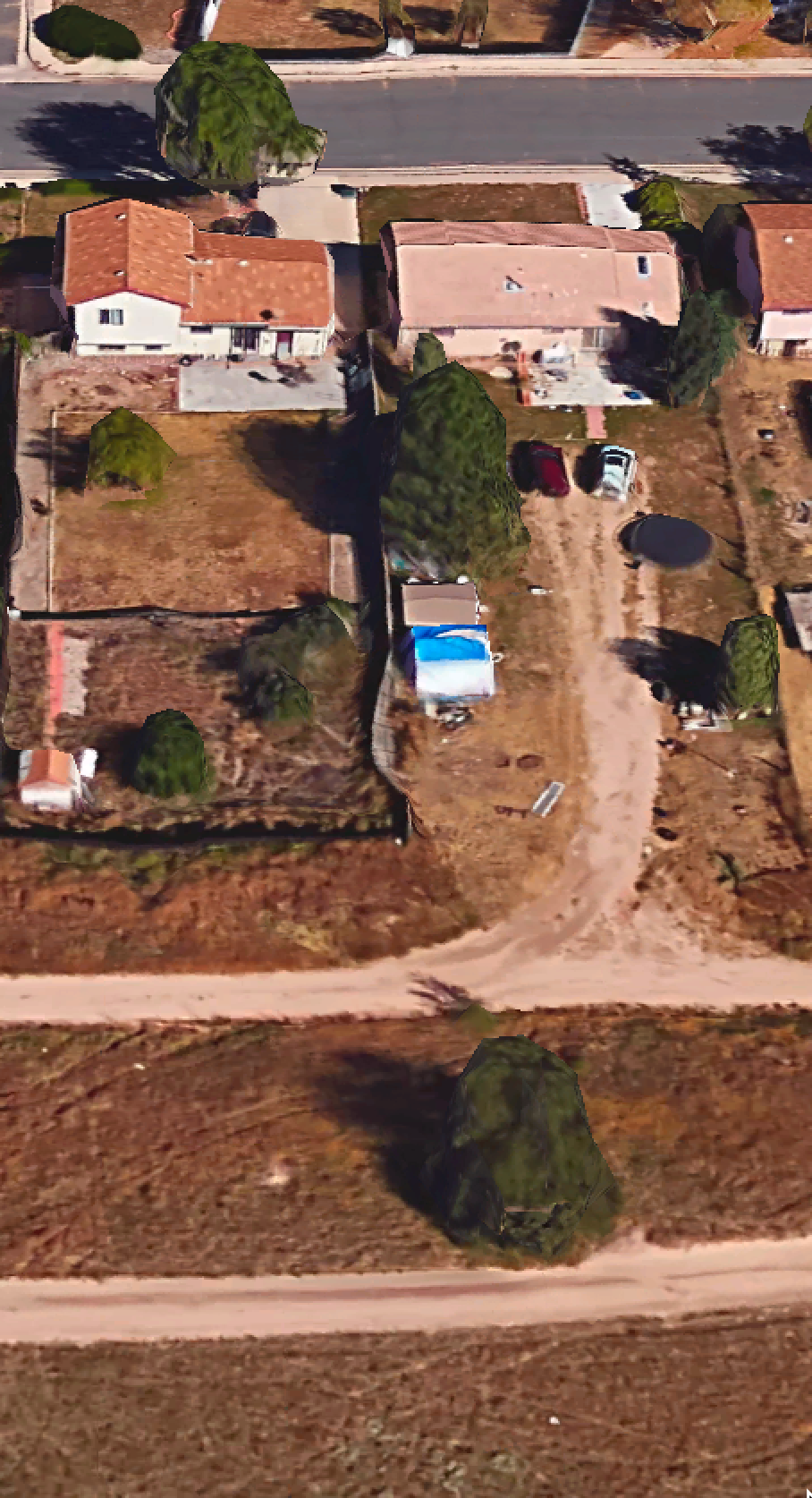

I don't have a good picture. Here's one from Google Earth that's a couple years old.
Both sites have significantly "deferred" maintenance.
Backyard 1 is ~125' deep x 63' wide. #2 is 125' deep x 60' wide. So 125' x 123' conbined. The front yards are similar -- originally sod, but long dead. Probably 40' of juniper / boxwood shrubs that need to go.
Most of the trees are gone or are going. We lost 3 in that big wind storm, and all of the fencing. There will be 1x large tree in front, and 1x large tree in back when I'm done.
One shed is already gone. The other to go. I'll probably keep the other two, but might try and have one moved.
I'm going to eliminate the privacy fence between the two and extend the driveway from the front, through the space where the fence used to be.
Privacy fence with gates along the back. Chain-link on one or both sides of the "compound".
Then bisect the backyard with a 123' chain-link. Thinking a detatched garage (or 2) or maybe some shipping containers if possible.
At some point, someone created a raised bed of sod, surrounded by landscape timbers. All long dead now. I've started pulling out the timbers.
The back 1/2 and around the sod was completely covered in river-rock. Maybe 2"? There's so much dead vegetation on top of it now you'd never even know the rock was there.
Negative-grade issue is near the house on the right (middle). They may have pulled dirt from next to the foundation to build a couple of raised flower gardens. Result is water intrusion into the crawl space.
My (uninformed) thinking was grade everything front-to-back with some material that was conducive to run-off (like dirt?), and then cover everything with a layer of gravel / crushed rock / something more decorative Xeriscape material.
Scope is the 2x co-joined backyards, then 3 front yards.
My original question was around what type of attachments -- if any -- would make this job easier / more fun. The Ratchet Rake is definitely an option. Or a 4-in-1 bucket. Or a rock / grading bucket, or a box blade, or perhaps some other thing I didn't even know existed.
No real timeline at all. My thinking is to have them deliver a big old pile of something and then spend the odd hour after work and frequent nice weekend spreading it around.
Probably doing the bulk of the landscaping BEFORE tackling the fencing.

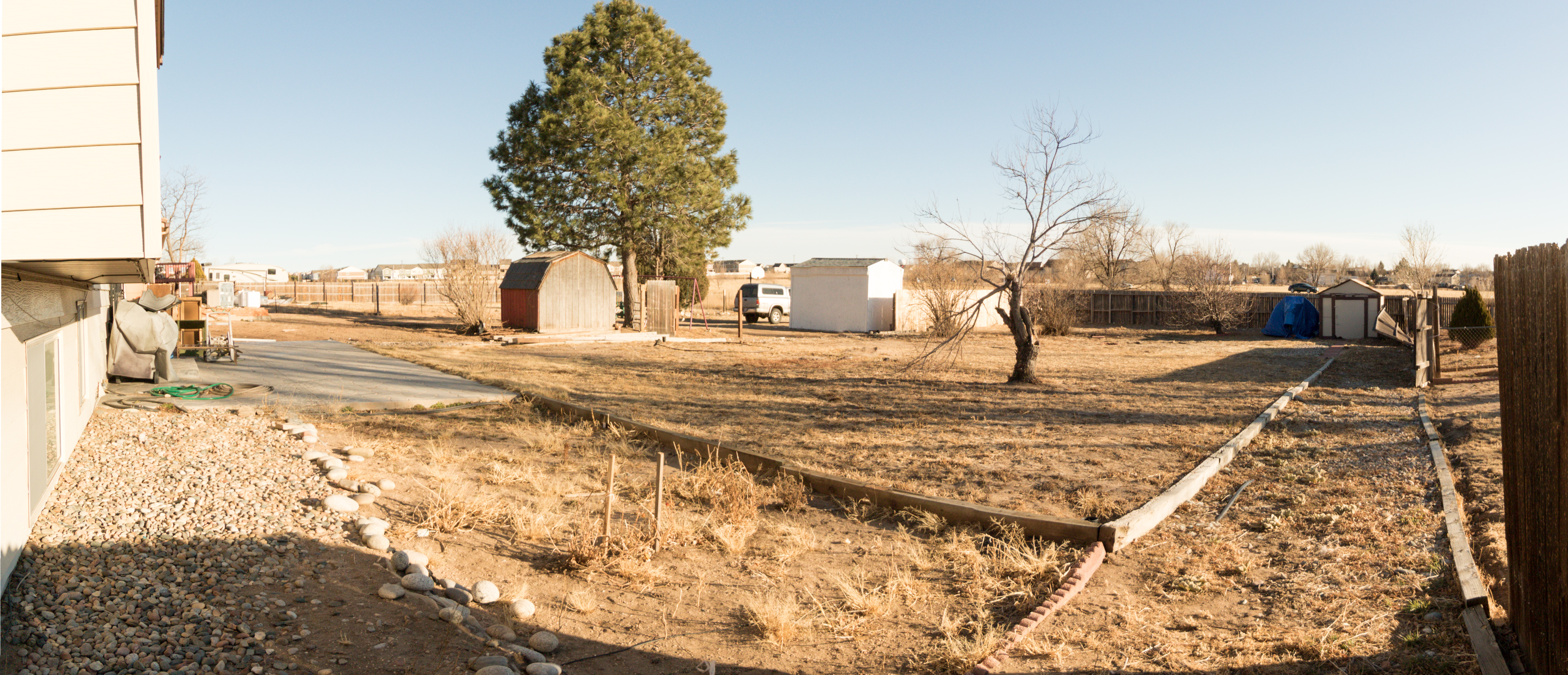

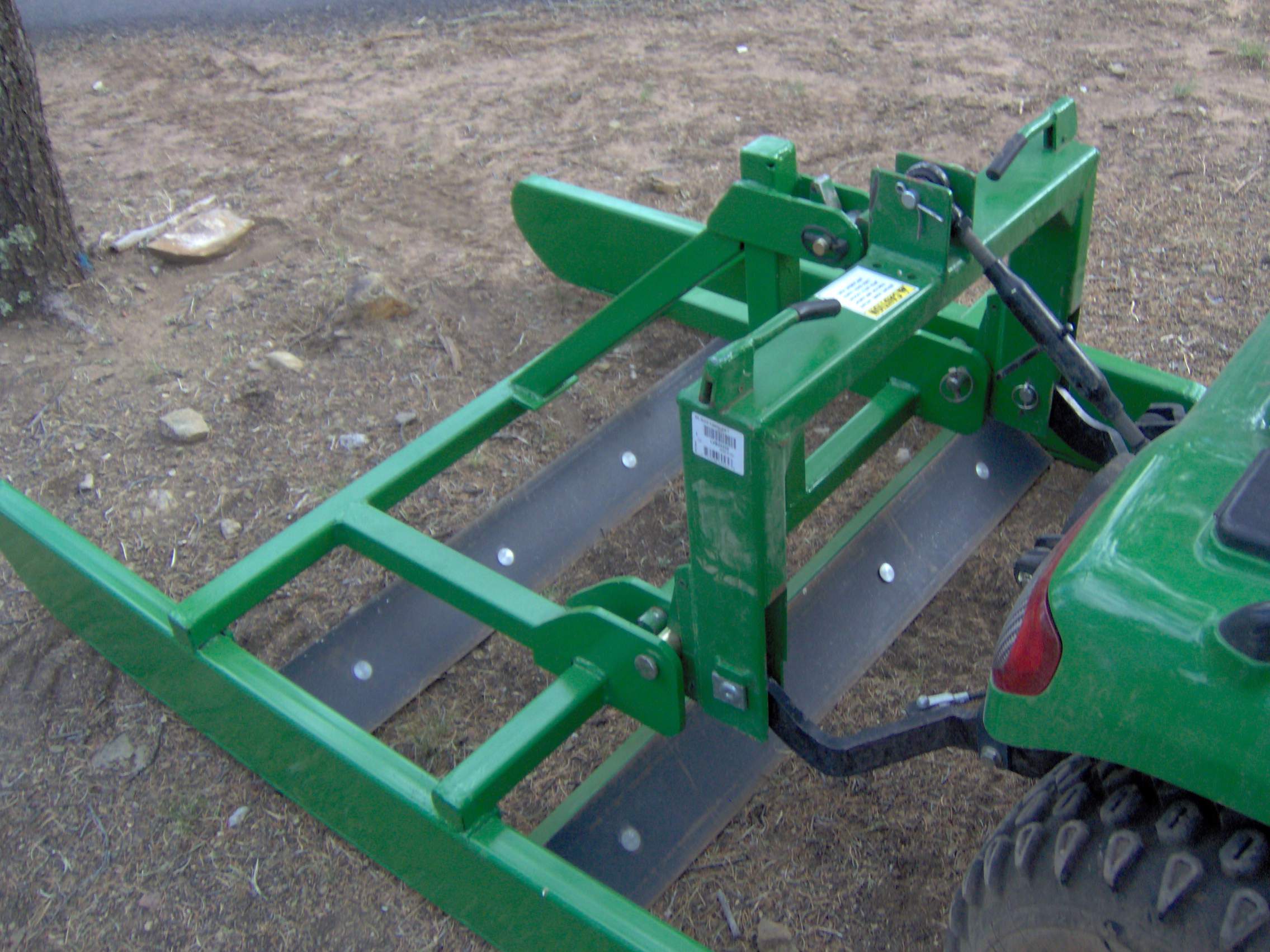

A landplane the size of the one in the pictures below would work well with your BX for smoothing. To run a uniform grade from the house across the yard would require a box blade or other similar implement that can carry the dirt and deposit it where needed. I would start by shooting grade to see what is really needed, you may find that there is enough slope as is to work fine. If that is the case you may only need a small amount of dirt around the house and a few low spots. Afterwards a lpgs may do the trick.
