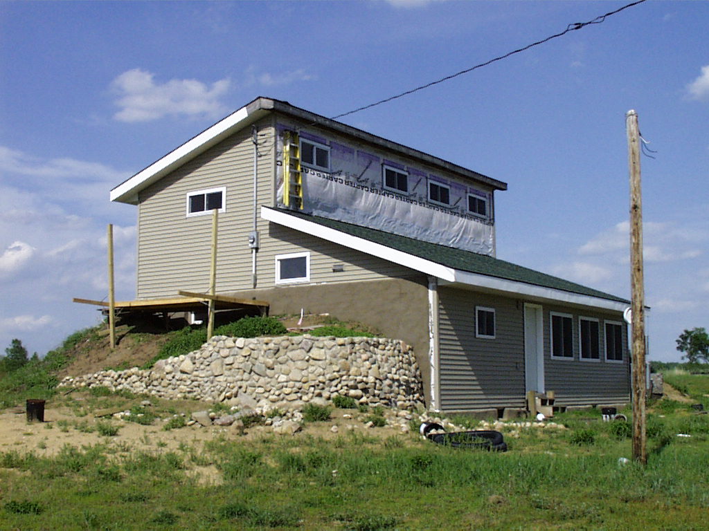

I believe in the energy thing this much.
SHF
   / Sloved the energy shortage problem #67
Re: Solved the energy shortage problem
Wow! Is that your place? Besides the partially underground part, what other features does it have?
We are still noodling on re-doing our place. Because of the monster mortgage we already have, I think it will be "some time" before we can actually do it.
The GlueGuy
   / Sloved the energy shortage problem #68
GlueGuy,
2x6 sidewalls. Cement walls are 8" reinforced concrete, 12' high. This allows for a 3' crawl space. You can see the vents in the picture. Crawl space has a slab, lights and GFCI outlets for storage, and will be insulated and drywalled to act as a "heat bank" for the furnace. The exterior of the cement (bermed walls) is covered with 3" of pink foam clear to the bottom of the footing. The foam is covered with diamond mesh and stealth fiber reinforced cement with a top coat of vinyl polymer modified mortar/cement. (Which altered the color so it matched the siding--that was luck, not planning.) The lower floor has one long room in front which is kitchen/dining/living room. The rear has 1 bedroom, 1 bath and a large laundry/pantry. The second floor is 1 bedroom, 1/2 bath and an office. Sidewalls are planned to be R22 and ceilings R44.
The stone wall (so far about 20' of middle completed), will wrap all the way around and be about 130' feet long. It will be 3 tiers high. The part you see in the picture is part of the middle wall. There will be a generator shed and a root cellar built into it. Plenty of stone for it. Got the rockiest piece of ground I ever saw.
The tall front wall up top allows room to retrofit in some solar when the technology catches up with us. The little windows are designed to catch the winter sun and bounce it off the ceiling upstairs providing natural illumination. Also, there are 2 cool tubes in the rear that can be opened and by opening the crawl space access and the upstairs windows, we can suck cool air from the crawl space through the whole house without need of a fan (natural chimney effect).
So far, we've been under construction for 2 years. (It WILL be done this year, my wife says so.) But, we've managed to keep ourselves relatively debt free, with only minor credit card buys when we absolutely have to do it and don't have enough cash. (I guess that's why my car has 309,000 miles on it.) /w3tcompact/icons/laugh.gif (No, that's because I'm cheap.) /w3tcompact/icons/laugh.gif /w3tcompact/icons/laugh.gif
This design really fit the place and if we'd got another piece of land I probably wouldn't have done this. The small town we're building near is at the bottom of a valley and my land is on top of the hill above it. Add to that-- everything is wide open field, farms on 4 sides, and the wind comes whippin down the plain. With that dirt bank, and no insulation yet, I've sat in there in windstorms and the only thing you can hear is the little tag on the electric meter going ting, ting. Should help alot on heat because 2/3 of the floorspace is sheltered from the north, west and east. (East side somewhat less so since there's a big ol egress window in the bedroom). I guess I'd better believe in energy efficiency being a selling point, because I've bet an awful lot of money on it! /w3tcompact/icons/laugh.gif /w3tcompact/icons/laugh.gif /w3tcompact/icons/laugh.gif.

I am truly impressed.
A neighbor built his "earth home" mostly underground (about 60% or so). His house is so efficient that he doesn't even have a furnace. On really cold days, they might just light a fire, but if they cook a pretty good meal, they let the left-over heat from the stove heat the house. Since it has a fair portion above ground, he can still open windows and such to modulate the heat. All in all, a pretty good design. They built it around 20 years ago, and it seems to be doing well.
Good luck on your project. Maybe we will get progress pictures? /w3tcompact/icons/wink.gif
