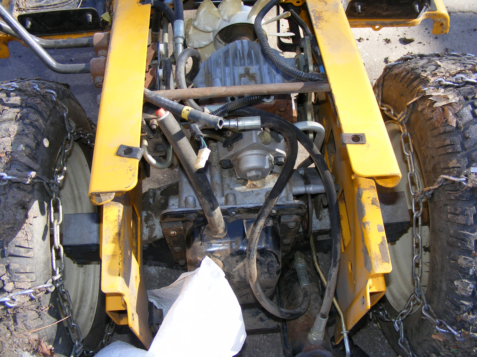

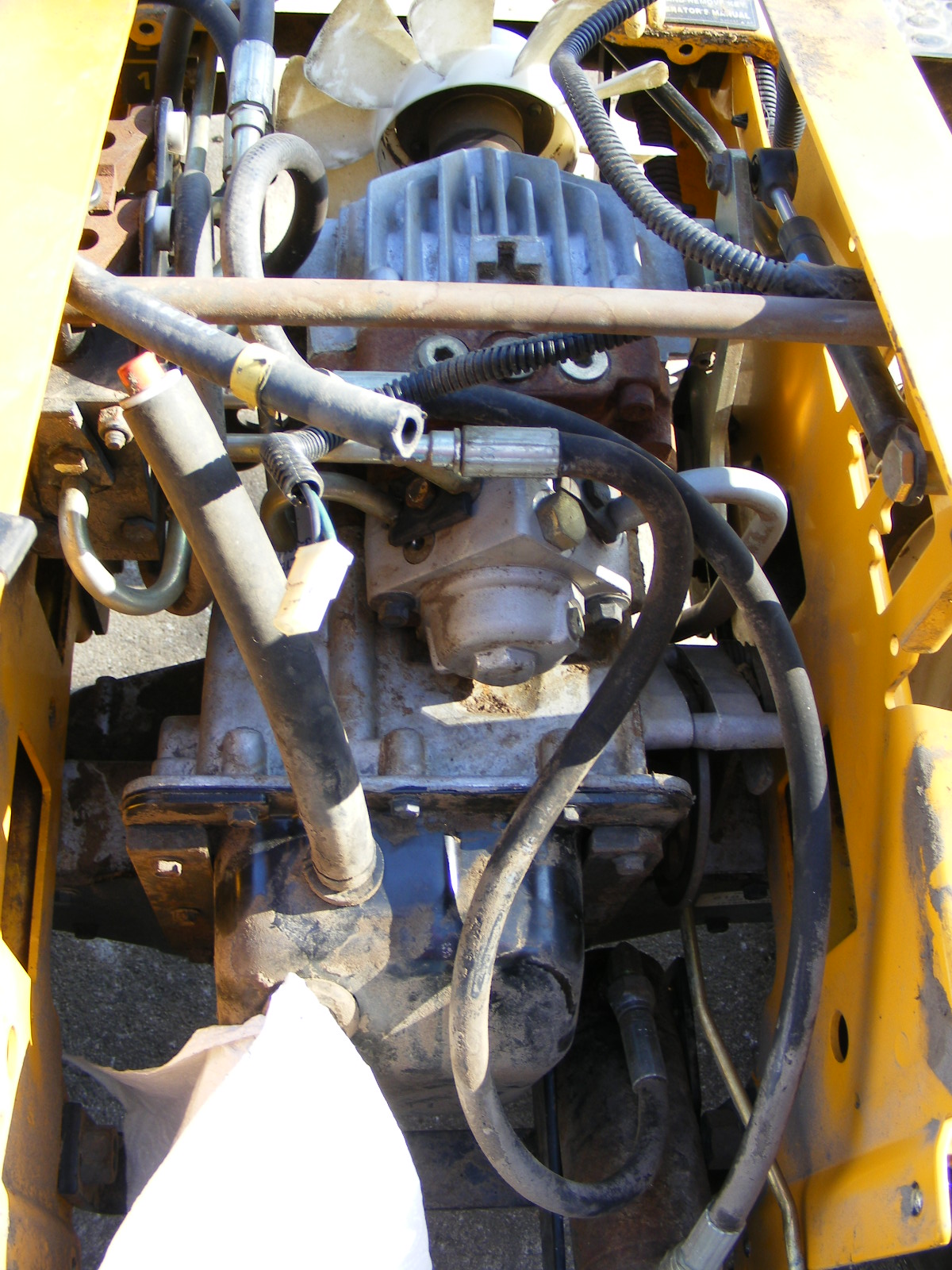

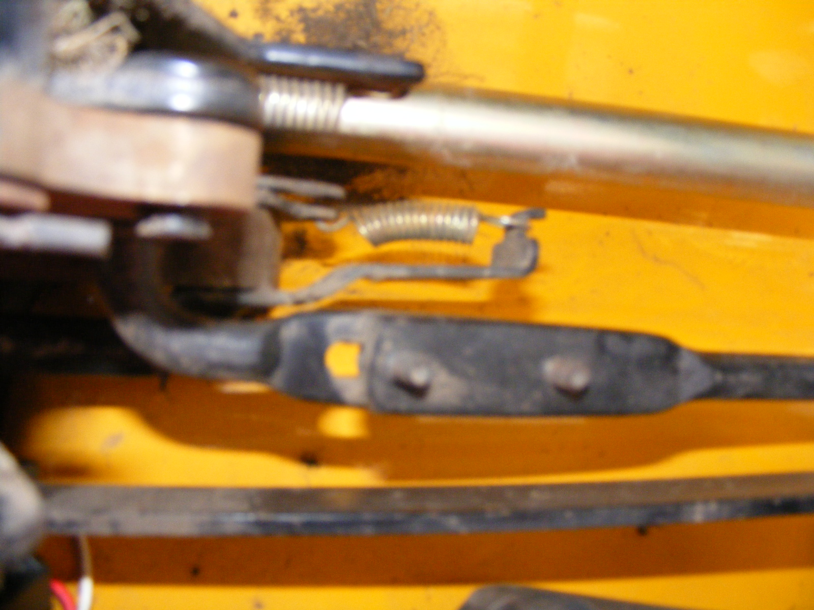

Attached are photo's of the forward adjuster as well as my Cub with the gas tank and rear end plate removed. I was trying to find any hydro leak that I could and I don't see a leak anywhere on this thing. It has to be a charge pump going out.

   / Slow 3184 #13
Just for giggles try this- find the hydro-releaase mechanism and make sure it isn't partially stuck open.. This would dump your hydro pressure and cause your low pump output.. Another thing to try is to block up the thing and run it elevated for a while to try and bleed any air out of the pump.. Good Luck..

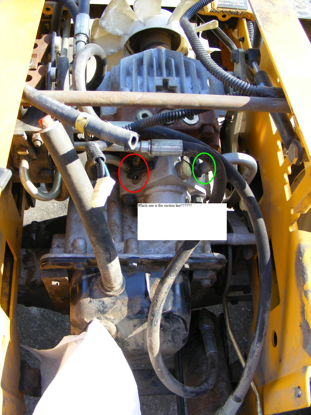

Ok since my cub dealer cannot get this fixed I need your guy's help. The leak is in the suction side somewhere. When looking at the charge pump from the back which line is the suction line. The one on the right that goes down to the bottom of the transmission, or the one on the left that goes up front?
If you look at the attached photo is it the red or green circle?
Also where all could the leak on the suction side be coming from. The Cub dealer replaced the "O" ring on the charge pump and the one on the transmission.
