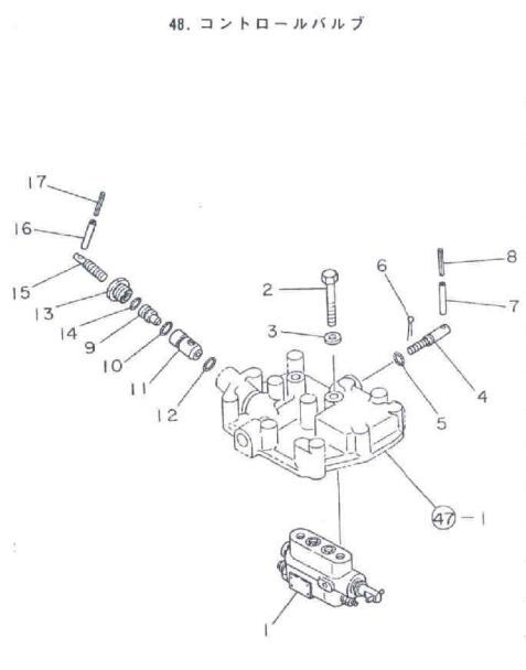

Yanman, Do the 1500 parts look anything like the 1510? Just wondering how much was changed.
   / Slow 3pnt. Movement?
#12
Wallysue, I don't believe the 1500 and the 1510 have the same setup. I have removed the adjustment assembly, and it looks like it is simply a threaded adjuster screw that goes thru a bushing that is both internally and externally threaded. I have sprayed it with WD40 and penetrating oil, didnt help. I have also tried heating the bushing with hopes the thermal expansion would help, Still no luck. Any other ideas would be appreciated.
   / Slow 3pnt. Movement? #13
yanman,
I have attached a scan of the hydraulic valve and housing from my YM1510 parts manual. I doesn't even show the bushing you are talking about, but it doesn't appear that there is any retaining nut, etc. Keep at it - you should be able to free it up, just be careful not to break anything.
Greg
   / Slow 3pnt. Movement? #14
Oh well they are completely different 1500 and 1510
