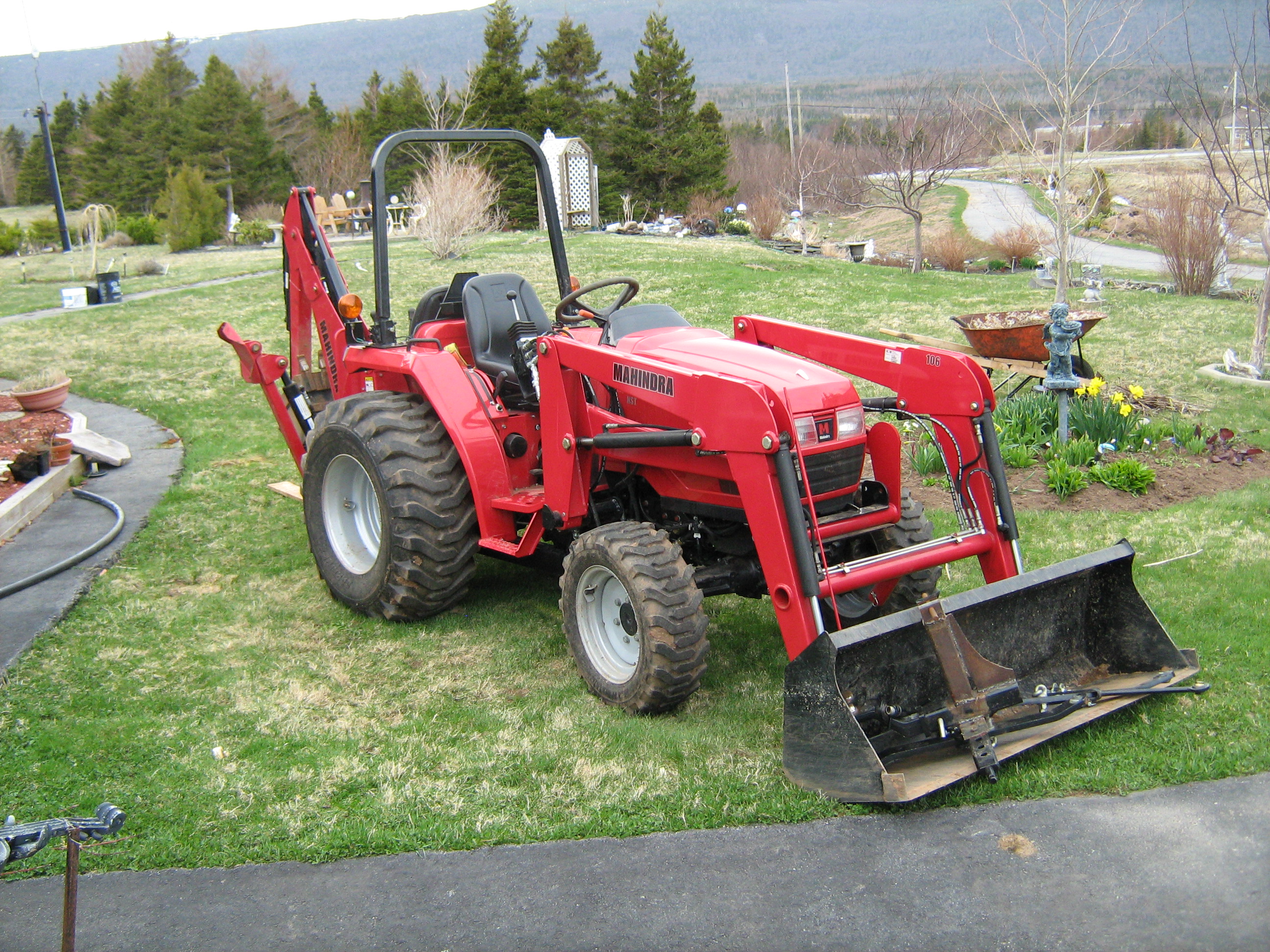

These features are slow on the tractor. Do ward function in the winter can be extremely slow to put the loader down.

No its very slow. may take 15 seconds or more to put the loader back to the ground . going up seems more normal. curling is not even that bad, but putting the loader down is very slow. When its cold even, it may take several minutes to put the loader back down.

Sounds like a valve problem.. My loader will move slowly in winter for the first 20 minutes and then moves as it should. There has to be a restriction somewhere for it to take minutes to drop it and flow the hydraulic fluid back to the tank from the cylinders.
   / Slow downward and curl function on mahindra 2816 . #5
Not familiar with the model...if it has a cable joystick first make sure it's actually moving the spools all the way.
If it is, try unplugging and reseating the quick couplers.
You can also try swapping the hoses around on the valve. If the problem remains with dump and lower you have a problem downstream of the valve. If the problem moves to raise and curl...you have a valve problem
   / Slow downward and curl function on mahindra 2816 . #6
Sounds like the valve spool is not positioning itself correctly. You might try removing the cap from the end of the spool opposite the handle. Be ready for loose parts that may fall out. Try shifting the spool carefully with the tractor not running and see how it reacts and observe.
Other suggestions above are good also.
The hoses on this block are screwed in. Yeah, it seemed to me they said quite some time ago theres a check valve in there some how, and it gets corroded. I do know that recently one of the hoses running to the block, not sure which one, chafed. I changed it but when I looked in the hole in which it screwed into...........I thought it looked brown. Rusty brown. I didn't have a good light, and was in a hurry to get another hose back on it. But I didn't like the look of it. I want the inside of the hydraulics to be clean. It concerned me a little. I haven't seen this post in a little while, but when it popped up again, it reminded me and I might write the dealer later to see what they figure....
