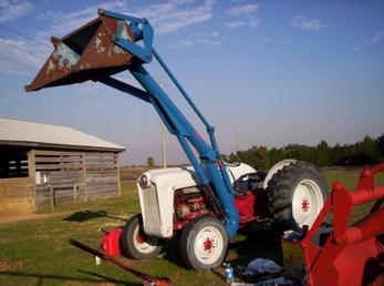

Your hoses should be fine..( the the oem ones were sufficently rated when you got it.. many i see are 4Kpsi minimum.. ) the pumps should pump about the same psi.. just more gpm.
Yep.. 13 seconds is pretty dismal.. considering this one from 1955 makes it to full lift ( 10' 5-3/8" ) in less than 10sec, 3000# breakout force, 1200# lift, 4gpm pump.
Soundguy
grsr3 said:
. The specs also say the rated flow is 8 gpm and max. press. 2200 psi. The raise time is 5 seconds----I tried my raise and it's more like 13 seconds----looks like it needs Viagra (hahaha). Guess I should be looking for a bigger pump. Not sure about pumps. Would a bigger pump put additional strain on the hoses and other plumbing---do they need to be upgraded, or not?? Also planning to add a hoe someday ----probably around a 7' footer. Should I get a pump based on the probable flow rate needed for the future hoe. My first job is to change the fluid. Will flush with kero, or can I use the "red" diesel fuel I use in the engine. It's a little cheaper. Also, what to do with 4+ gallons of UTF???
Thanks again, George

   / Slow hydraulics in winter #28
Try using ATF. It's an expensive hydraulic oil, but sure does flow in cold weather. Also does not foam like some other types oil, and a terrific lubricant. Seals that tend to harden and crack can be softened up as well with the use of ATF.
