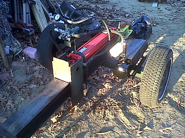

Hi folks, recently my FIL picked up a home made logsplitter. After doing some modifications on how the motor/pump was ghetto mounted it now runs pretty good. The thing that bugs me is how slow it is to extend. The pump is a 2 speed 11gpm Haldex running a 4" cylinder. Attached to the pump is a 6.5hp vertical shaft B/S motor. The 2 hoses that carry most of the pressure have been replaced and are decent sized. The fluid coming back does not appear to have bubbles. The pump feed hose also looks big and seems fine. According to a hydro calculator it should run 202" a minute, it's no where close. It does seem to slow down when it hits the wood and it pushes right on through. The gauge hits about 500 when it gets under load. When maxing out the cylinder (accidentally) I saw the gauge go up to 3k and the motor bog so it can build some big pressure. Any thoughts on what to check?
I've perused many posts and haven't noticed anything they've mentioned as issues. I'll add some pics soon. Thanks.

At 11 GPM and low pressure, your extend speed should be around 7 sec, at 3.4 IPM
I suspect you are running in the low GPM mode and high pressure, or something else is wrong.
At 3.4 GPM and high pressure, your extend speed should be around 24 sec, at 1 IPM.
Is your engine running at max rpm.
Is the love-joy coupler loose on the engine to pump? Are the filters clean and not obstructed, or reversed?
Is it a return filter or input filter?
Is the IN hose and OUT hose reversed?
Can you make a video of the cycle time?

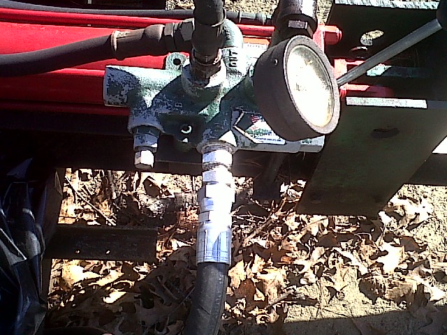

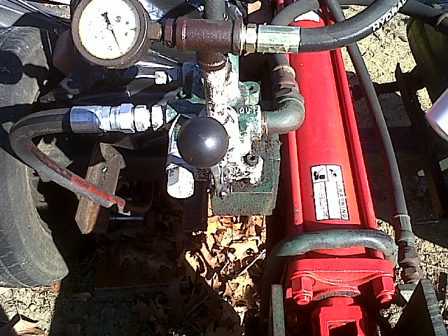

Can you show a better picture of the IN port and A port fittings?
   / slow log splitter #5
Leejohn, are you thinking of a restrictive fitting on the input hose, and the cyl fitting?
Maybe he should remove those fittings and look through them.
   / slow log splitter #6
Yes and with the picture not being clear they look small. I had hoses made for my small dump trailor and they put a fitting on, the hole was less then 1/8". I have sa cyls, just put it on the down side so it worked out good.

Here's some closeups of the valve and hoses attached. They look to be as big as the fittings allow.
