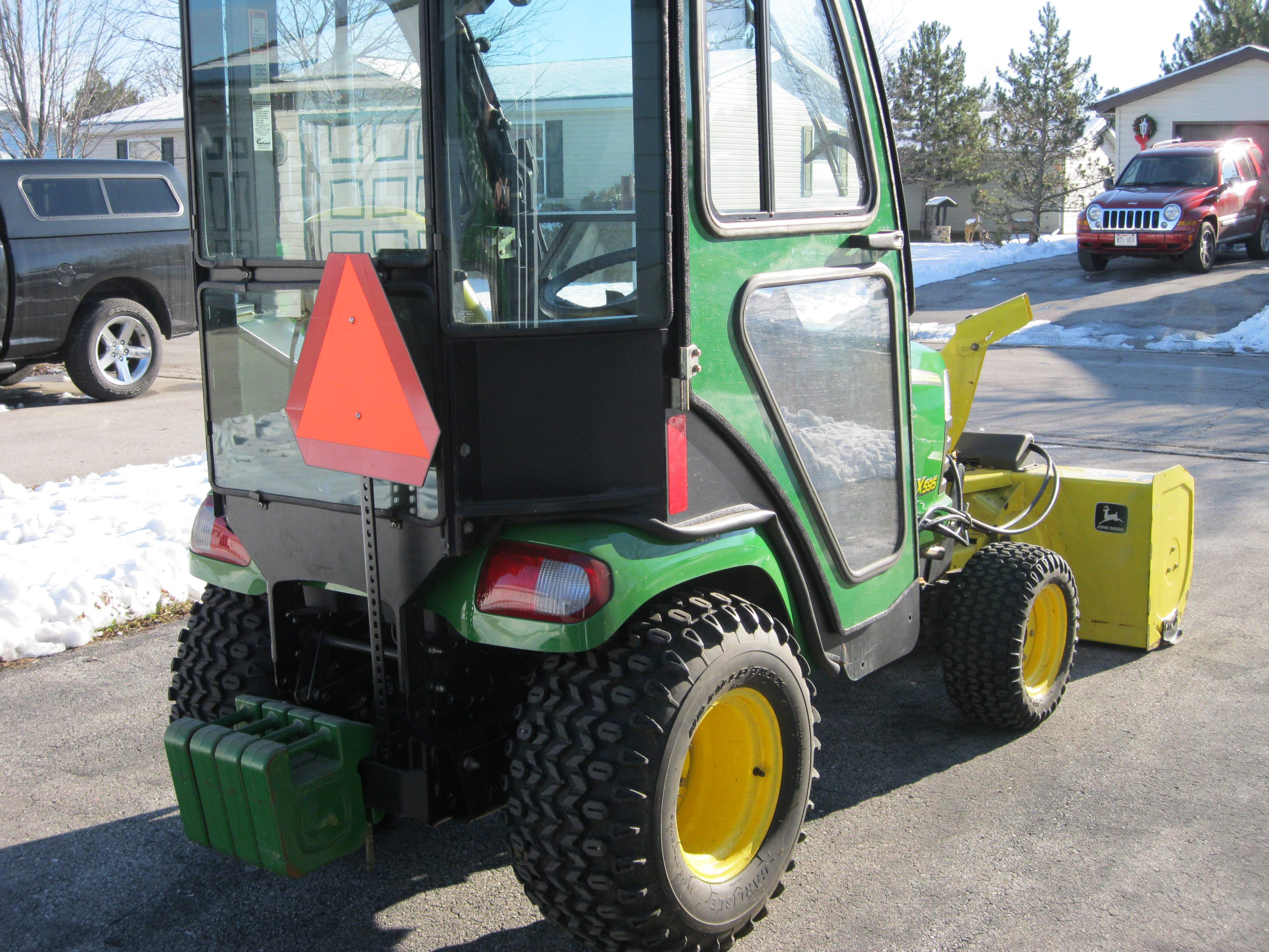

Attached is a picture of my X595, which is identical to the X748. All you need is a L bracket about 3' long with holes drilled in it (available at any hardware store) and a slow moving triangle. I bolted the bracket on the bottom to existing holes in the frame of the tractor and the sign had 2 predrilled holes which I used to attach it to the top of the bracket. Works with either my cab on or off.
