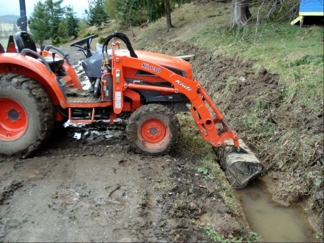

heres a couple of pics of the kioti cleaning out my ditch...... IMAGE001.JPG
