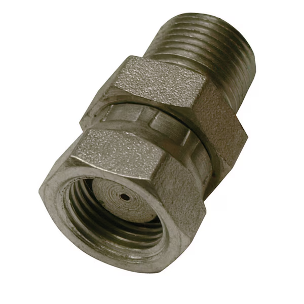

I have a 72 inch Pto snowblower on my ck3510 tractor. The chute moves much to fast up and down as well as sideways. I know I can install a needle valve to adjust the speed but I really don’t want to install four one way valves and bidirectional valves are not at my disposal. If I installed a piece of round stock with a hole drilled through the Centre in the lines where they attach to a threaded coupling, will this work? It shouldn’t be any different than the valve.
   / Slowing down hydraulic snowblower controls #2
Is the rotate a motor or a cylinder? If a cylinder you just an orifice in one line typically the cap end.
If a motor you may have to have an orifice in each line metering oil in and free reverse flow to prevent back pressure which could damage shaft seals.

My broom swing cylinder lines have brass disc inserts that have about a 1/2 mm or less restrictor oriface disc hole in them. about a mm thick. JD part no. N204464. But, these lines have flat faced connections, not pipe or tapered.

TSC has restricted fittings available (male and female pipe threads) with an approx. 1/16 in hole for flow control. They can be drilled larger if too slow. One per cylinder should suffice. I have a number of them in use on: a front mounted snowblower lift cylinder, a dump cylinder on a 3 pt mixer, a swing cylinder on a 3 pt rake, and a top link for the 3 pt lift.
Unfortunately I have no access to a TSC, but I’ve seen those and I would purchase them if I had access. I can’t seem to find that particular valve in Canada.

There is usually an adapter between the hose and the actuator (motor or cylinder).
What I've done in the past, was to partially tap the hole in the adapter, then just use set screws of the same thread with a very small hole drilled (this can be drilled till you find the sweet spot or even do various set screws with difference hole sizes).
Finally install the set screw in the adapter, which will bottom out on the thread, hence why it's a partial thread and won't go all the way through, so it's locked in place. There is not real need for any thread locker or sealant.
