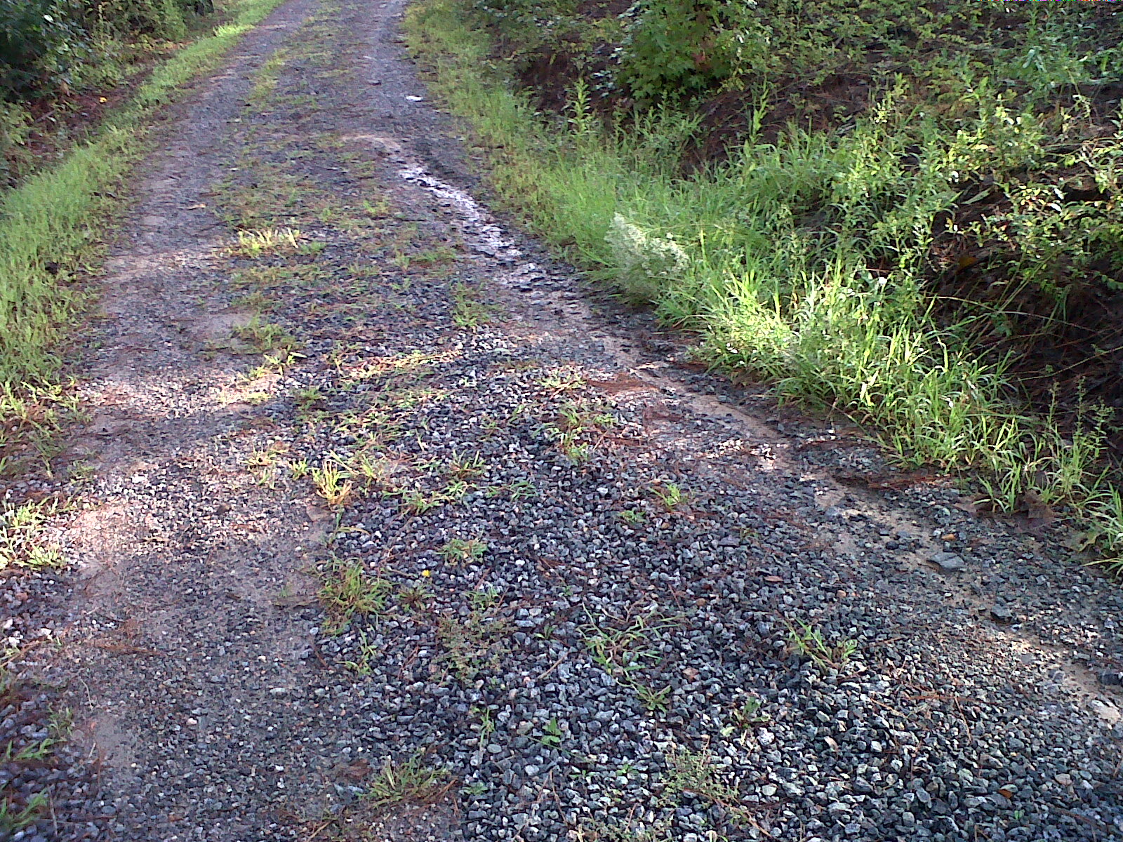

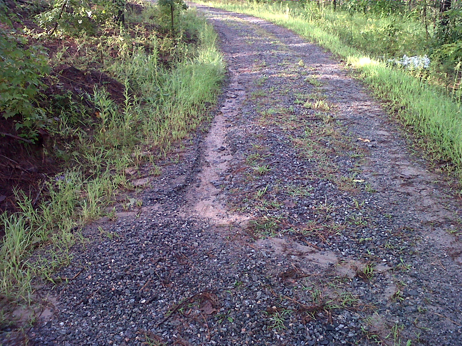

All, here are 2 shots of the worst spot (not that bad really).
One is looking up, the other looking down.
David

It looks well-crowned. Practice the backdrag in the center of the drive a few times. That's a sparse amount of gravel so I would be careful not to "smear" too much of it into the ditch.
It's amazing what water will do to rocks.
Consider investing in a drag harrow too. My box blade is good for major repair but it's more of a hammer than scalpel. I made a harrow from about 8 feet of chain link fencing, a 4x4 and a cinder block. (Although I had to purchase 50' of the fencing). A few quick passes with it and gravel is nice and smooth.
When I'm done, I drive the tractor down my driveway a full speed with my tongue sticking out. If I don't end up biting my tongue in half, I've done it right.

So the land to both sides of the drive way is VERY steep, one side drops, the other rises. I cannot get the tractor sideways on the drive. I'm worried about knocking down the little crown I currently have... Am I crazy?
