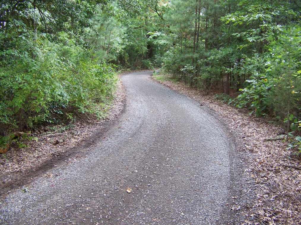

So the land to both sides of the drive way is VERY steep, one side drops, the other rises. I cannot get the tractor sideways on the drive. I'm worried about knocking down the little crown I currently have... Am I crazy?

It looks well-crowned. Practice the backdrag in the center of the drive a few times. That's a sparse amount of gravel so I would be careful not to "smear" too much of it into the ditch.
It's amazing what water will do to rocks.

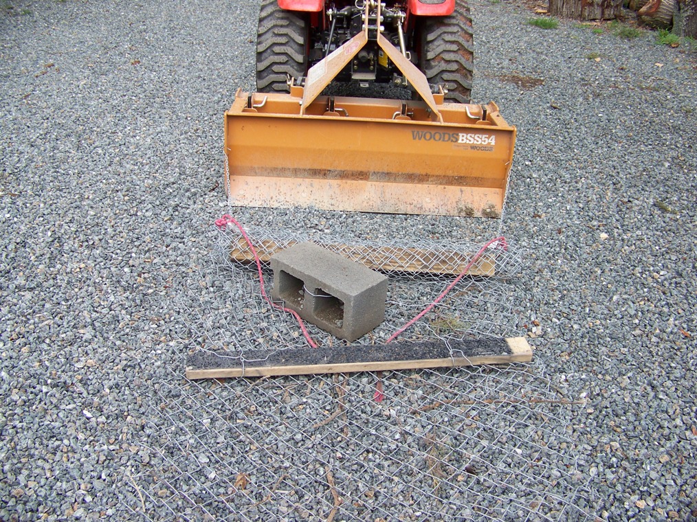

Consider investing in a drag harrow too. My box blade is good for major repair but it's more of a hammer than scalpel. I made a harrow from about 8 feet of chain link fencing, a 4x4 and a cinder block. (Although I had to purchase 50' of the fencing). A few quick passes with it and gravel is nice and smooth.

It appears from the images that the crown is not working. The runoff is supposed to flow across the road and into the ditches and not down the road. There looks to be a shoulder betwen the road and the ditch that is holding the water and causing it to run down the lanes.
   / Small amount of rain washout on my gravel drive?
#18
Massey,
There is not much crown, but it has been working fine. But we've har so much hard pouring rain this week. I'm almost afraid to start the tractor. I have standing water almost EVERYWHERE. My ponds are almost at spillover.
I have not been able to get out into the forested 42+ acres, but I fear I've got many more downed trees than I know of already, and all the trails are slimed.
I suspect last night's rain was just too much, too fast, on top of saturated ground.
I will try to do the wiggle method described and rebuild the crown.

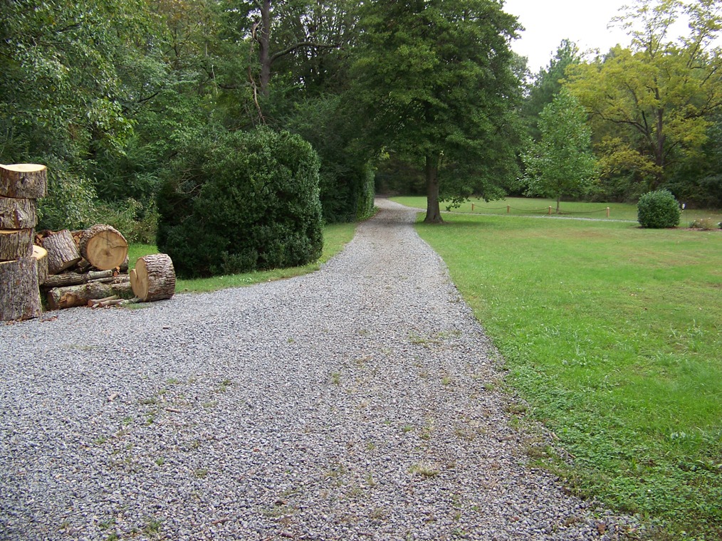

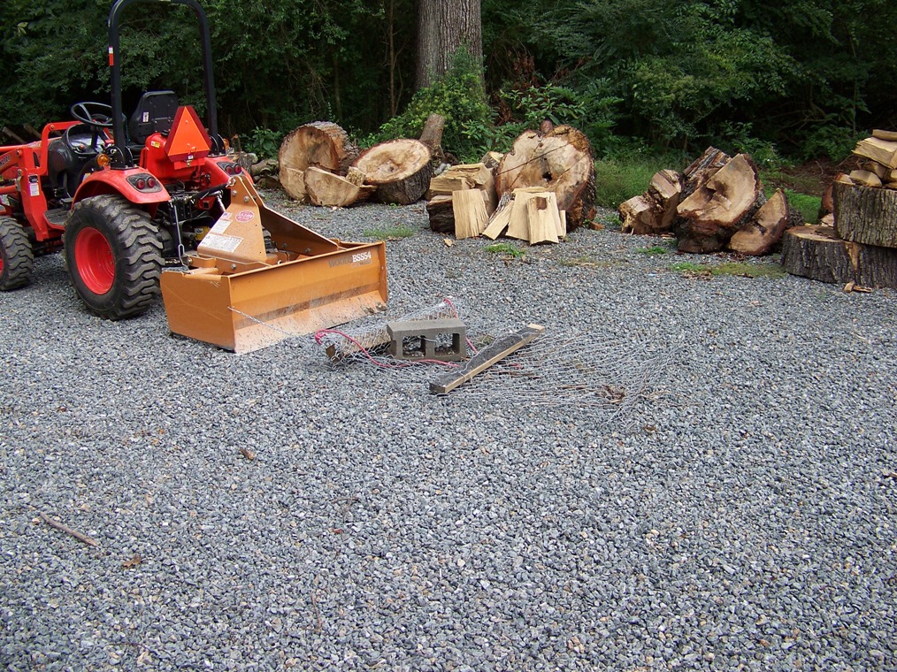

A little late, but here are pics of my hi-tech harrow. I failed to get any before pictures of the driveway but I've included some "afters".

All, here are 2 shots of the worst spot (not that bad really).
One is looking up, the other looking down.
David
What you have there is loose rock on a road. It looks crushed at one time, and sized about the same, which looks to me like it's a decorative or top coat type of rock. It is NOT road base.
No matter what you do with this type of rock, it will continue to move on you. Your ground under this rock must be very good. Is your soil rocky?
Road base is a rock that is crushed with the rock varying in size from an inch or so in size, down to fines. The edges of the rock are jagged. When spread out with a thickness of at least four inches, and compacted, it interlocks and becomes a solid surface that will shed water and support vehicle traffic.
If you have less then four inches, it will not hold up or remain locked together. This is when you get pot holes. NEVER take away from one area and use that to add to another area. BUY MORE ROCK!!!!! Mixing the new rock with the old rock will ensure a uniform compaction and long lasting repair.
The box blade is an OK tool for initially spreading and smoothing out your gravel road. It is also a fair tool for fixing a pot hole or low area with NEW rock. It is a TERRIBLE took when used to smooth out an existing road. All that it accomplishes is to thin the amount of material that you have, break up the compaction of the existing rock, and SPEED UP the decay of the road. The more a box blade is used on a gravel road, the more damage is done.
