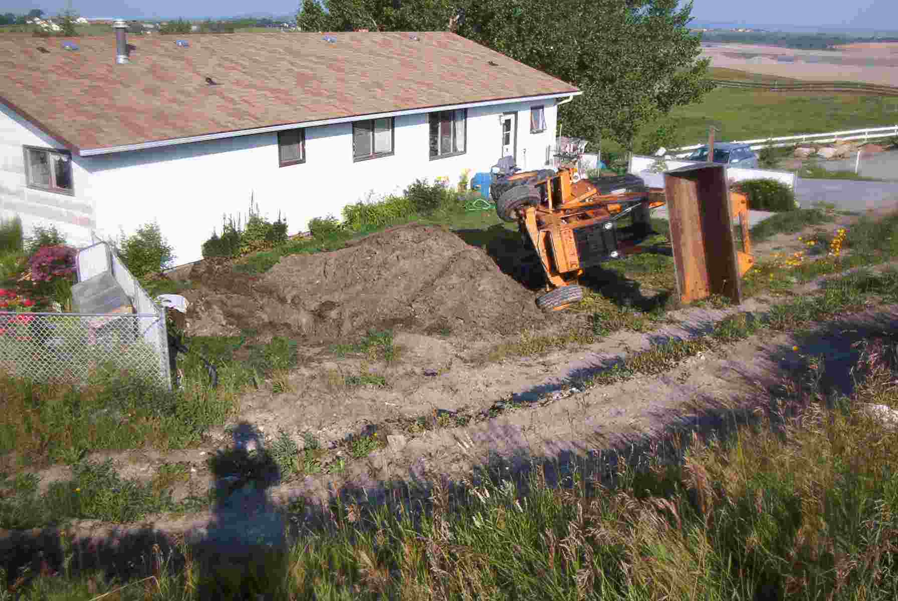

Here is an example of how NOT to move a backhoe. The operator was fine but mad at himself. Apparently this was the first incident in 30+ years of operation.
Back to the subject... it took two days of digging to trench from the house up this 23 degree slope to just behind the photo position. Lots of clay and shale boulders.

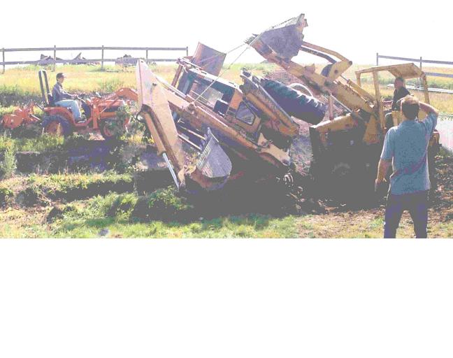

And in case you're wondering, this is what it took to upright the backhoe. Naturally during the uprighting process the back tire under the backhoe popped off the rim.
The bulldozer couldn't do it alone so Kubota to the rescue!
