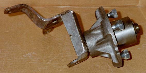

Nice job.. my Dad has a cub-cadet that's almost as old as me.. pushing 40.. it's still going strong. I was wondering if the weight capacity of the front axles is a safety concern w/ the FEL loaded.. I know the weight is distributed to all fours.. what is the max load for the front tires. If my Dad had those attachments back then.. he probably would have never come inside.

Ken,
i modified the front spindles using the existing spindle brackets but replacing the spindles with 1" and using 4 bolt trailer hubs with tapered roller bearings. then i picked up some 4 bolt hubs and used my existing 4 ply tires with tubes. i estimate the carrying capacity at 1000 lbs.
i have pics of the project as well as part numbers and suppliers listed if you are interested. here is a link to my site... P.F. Engineering click on "photo page" for the spindle upgrade pics.

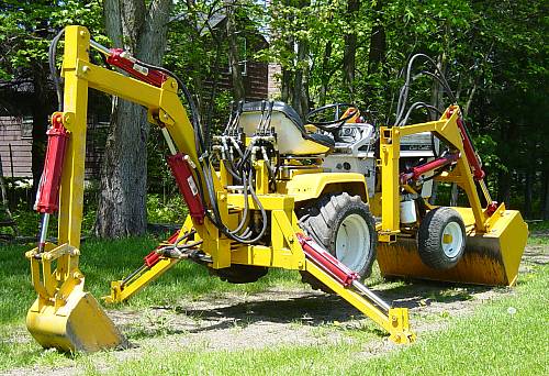

i've updated the pics of the Micro hoe, thought some of you may be interested.... Micro Hoe

What a great looking machine! /forums/images/graemlins/grin.gif Gee...you're close enough to me that I could attend a "show" if you ever decide to display it. Real nice work.
You seem to be very handy with the metal work. I can't help but notice that with the loader up that high, that tractor is probably going to be pretty tippy. Have you thought about fabricating a ROPS for the tractor? Not sure if it's possible on that unit, but it seems like you did the "unprobable" with it already...so why not try the "impossible"?

Nice job. Have you thought about a ROPS for that bad boy? (FEL work might be more "comforting" with one on the machine...) The challenge might be mounting one to the frame to insure it's sturdy.

Rick, Jim,
thanks and yes i have felt the need for roll over protection. i have also been considering dual rear wheels for the same reason but for now i make sure the full bucket travels close to the ground just in case. the hydraulic stabilizers have provided a bit of added insurance at times too! heh. if you would like to stop by and take a look Rick, or anyone else, let me know.

NICE JOB. HOW MUCH DO YOU HAVE IN MATERIALS FOR THE BACKHOE. HOW MUCH DOES IT WEIGH. THANKS

</font><font color="blue" class="small">( thanks, i designed it myself. )</font>
Great job!
A little off topic, but I love your FEL bucket design. I have some definite ideas about what makes a good bucket, and it seems like the commercial suppliers do not.
