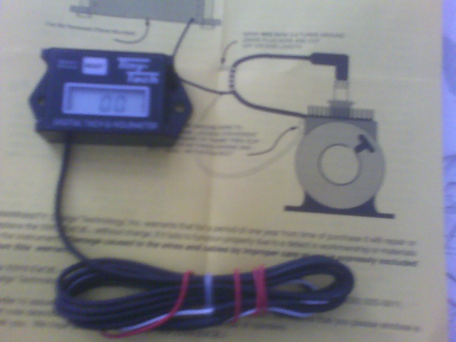

Thanks for the info all, I will most likely try to find a tach this weekend someplace locally. If I can't find one locally, I'll order online. I'm not in a big hurry as I have all of my wood split for this year. I just wanted to do some work on the log splitter as a Winter project. Since it is home made and I don't know a lot about it, I thought it would be good to know the RPM range of the engine, pump output, etc. so I can run it at the best speed and not cause any damage ny running too fast.
I ordered a new 10 gal hydraulic reservoir since the one that is on it is only about 2gal max. not big enough. Still trying to find the pump GPM and pressure ratings. Plan to add a pressure gauge and a filter as well. I'll probably have about $500 and a little time in it when I'm done.

Got my Tiny Tach today. Looks like a well built unit, just what the doctor ordered for this application. Thanks for all of the input on this!

I think the name of the unit is Digitech or Digitron???
It is a small electric gauge used in racing go karts. The RPM sensor is zip-tied the spark plug wire. The heat sensor is a ring that is sandwitched between the head and the spark plug. You should be able to pickup a used unit at a good kart shop or Ebay.

Thanks for the info OSA, I found one online the other day and ordered it. This one is called Tiny Tach, looks like it will do the trick.
