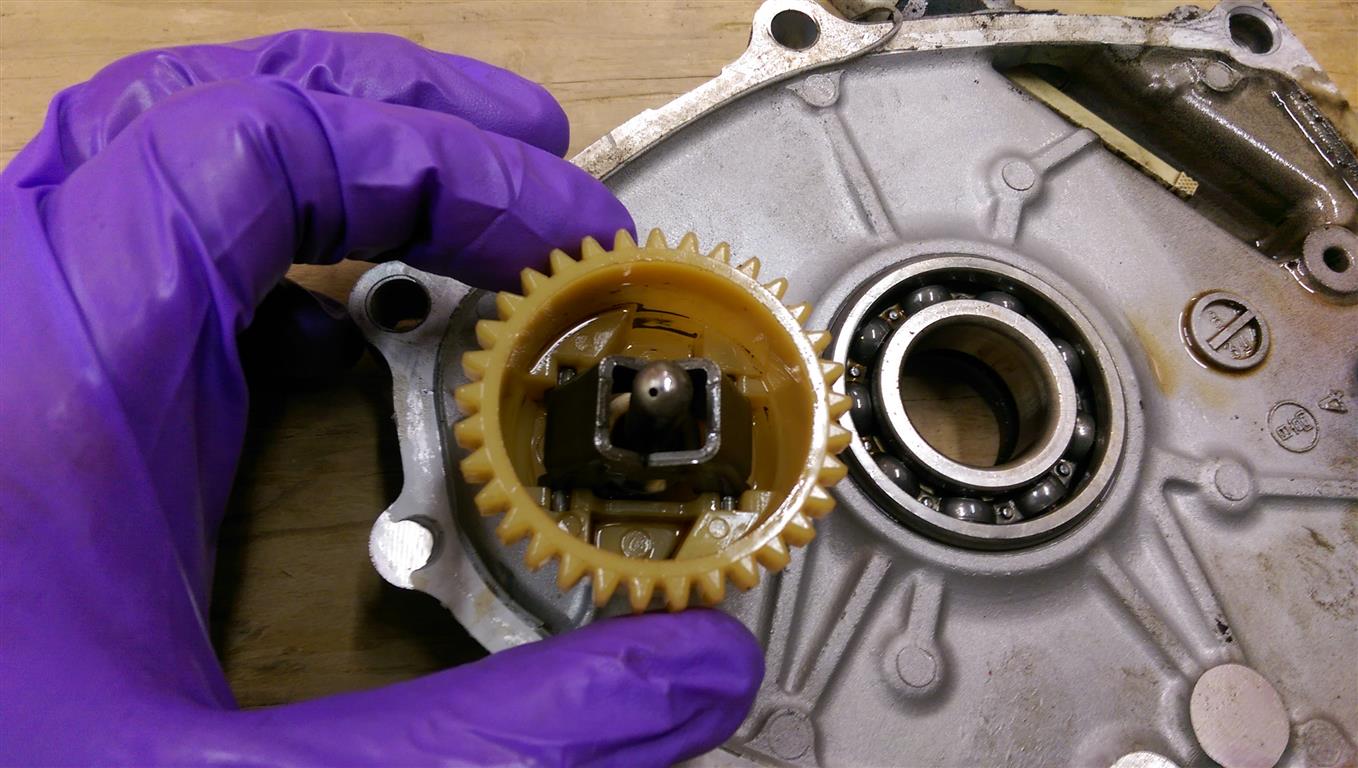

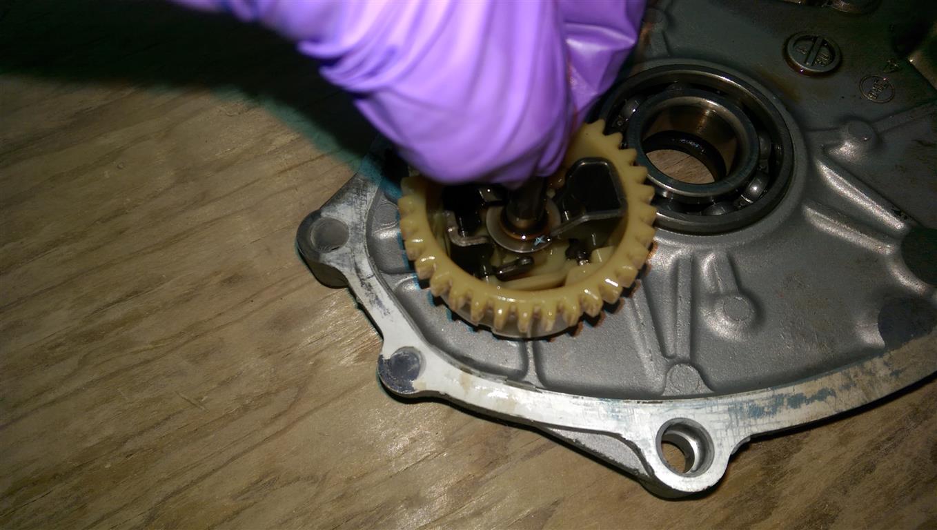

I had some time tonight so I tore into the crank housing to check the governor. Attached are a couple pictures. As far as I can tell, it is working perfectly. The weights move freely and mover the plunger in the middle freely. No binding in the mechanism anywhere I can see. Gear teeth all preset and in excellent shape, both gears. Everythign spins freely. I double checked the governor arm to throttle connection and what I said previously is true: There is only one way to connect it. The hole for the spring is too small for the governor rod to fit into, and there are only the 2 holes - big & small.
So now I am really puzzled. I guess the only thing that can be wrong is the carb, where it all started, but it doesn't make any sense to me how. I had no luck finding a service manual online for it either. I can find parts breakdowns on the repair parts sites, but no luck with manuals for this series.
Anyone have any other clues? I'm at a loss...
Here is the governor mechanism
/ Small engine trouble #27
Typically, the governor spring will hold the throttle wide open when the engine is NOT running. When the engine IS running, flyweights (or fan sail) try to force the throttle closed. The faster the engine runs, the more force applied to close the throttle. As the engine slows down, less force is applied to counter act the governor and the throttle is allowed to open. This action is what allows the engine to compensate for different loads.
The spring only tries to hold the butterfly open at full throttle. When the engine is throttled down, the butterfly closes and the governor does nothing. If the throttle does nothing, it's a carb problem, not the governor. The first thing I would check is to see if the throttle cable is out of adjustment.
