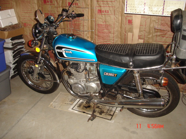

Fordlords-- took my '75 CB360 out yesterday for about 20 miles :D:D (Then hosed it off...:mad:) I'll probably get the '82 Virago 750 running today.... I stopped running them on a regular basis in December this year, gettin' too old for a 12-month cycle experience in NH!
