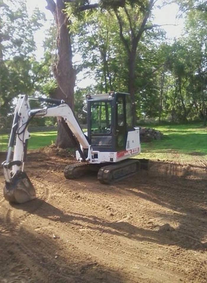

I loved my Bobcat 335. Great machine. The thing with a mini excavator is it really depends on what you are gonna do with it. I have had quiet a few, and trust me you don't want to go cheap or too small. Make sure the machine is in good condition. The best advice I can give you is make sure that what ever you buy has a hydraulic thumb. You will use it A LOT. Wouldn't buy a mini without it. Good luck with your purchase!
Some of the ones I have had...
